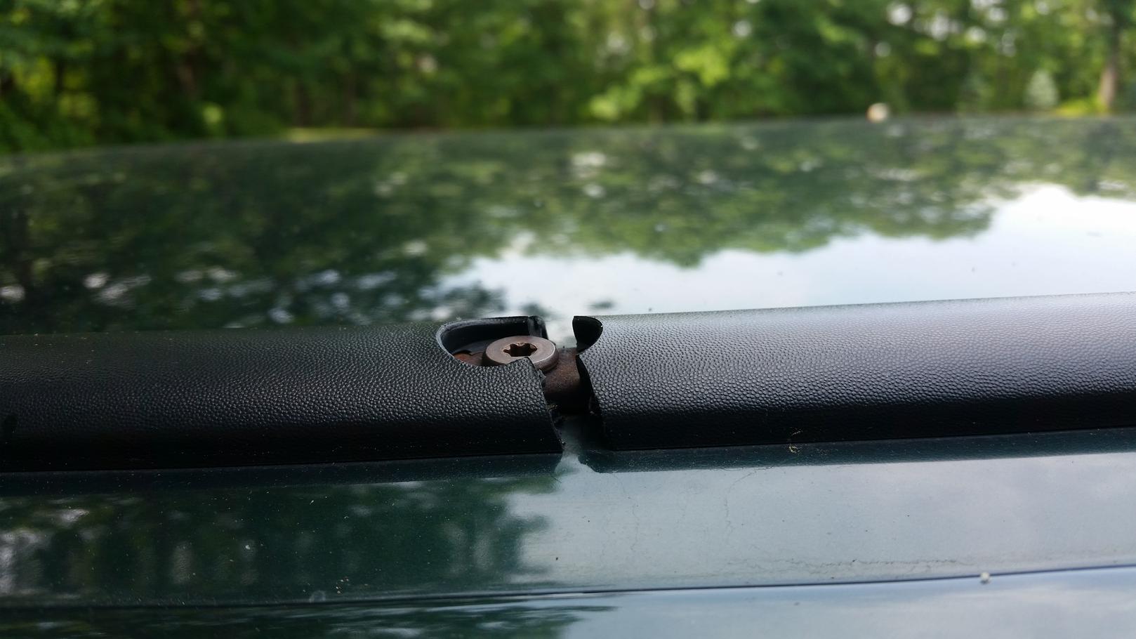

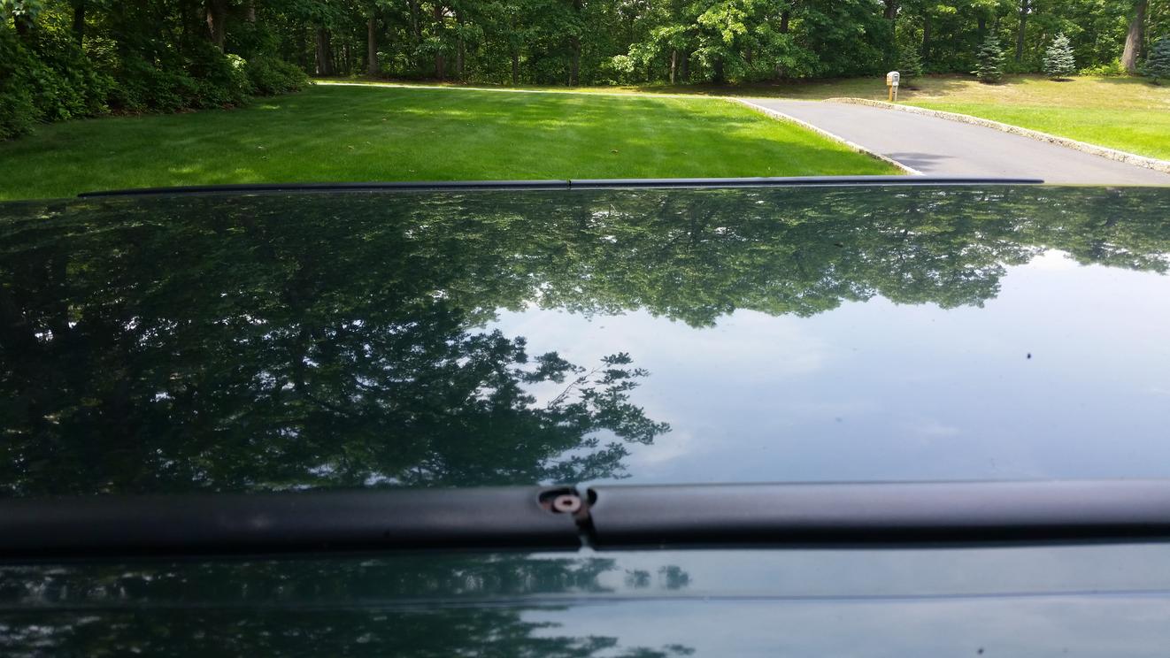

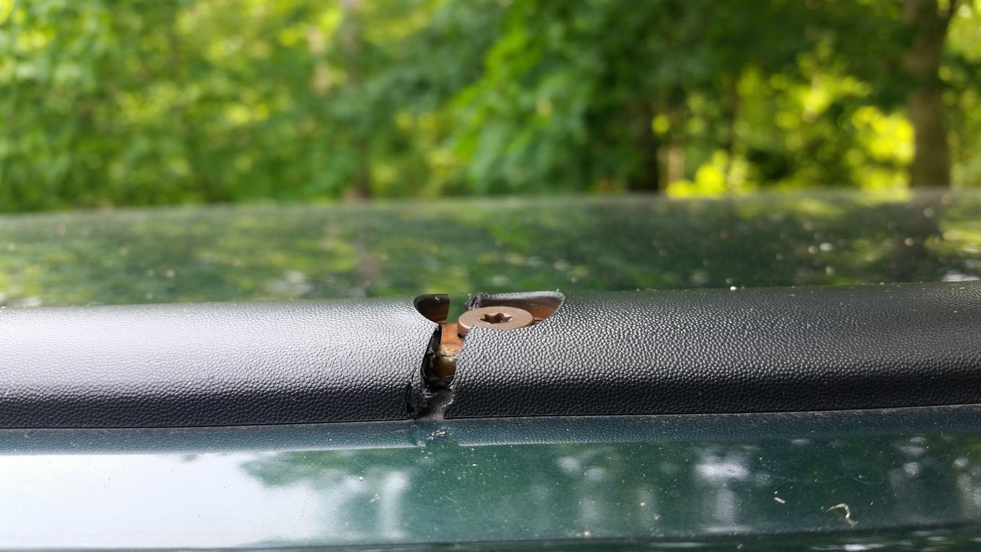

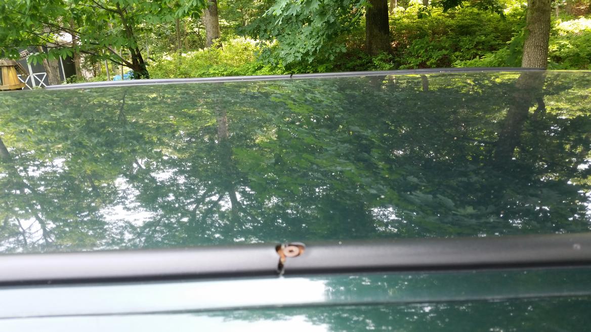

Is it just a coincidence that both sides of my plastic roof rails are cracked in the same spot? Are they supposed to be like this?

Had the same problem on my 1997 t4r, probably expansion/contraction as I park outdoors......found a set of the same rails on ebay for a very reasonable price. Now I use Mother's Back to Black often on them.
The plastic is old, and has been exposed to the Sun and heat for 14 years. It shrinks and cracks at the weakest spot. You could fill in the gap with some black silicone, so it's not as noticeable.
If you want a roof rack, I'd find one off a 3rd gen 4Runner in a junkyard, remove the factory plastic rails, and the factory rack will bolt right in place.
Or, maybe someone on here has a factory roof rack for sale.
