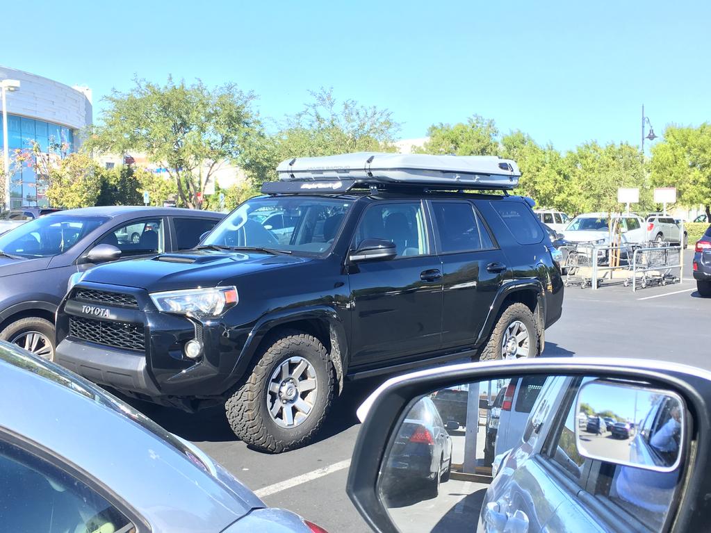

I have a picture of one running the Bajarack with a James Baroud. Not sure who the owner is but it'll give you an idea of how it looks.

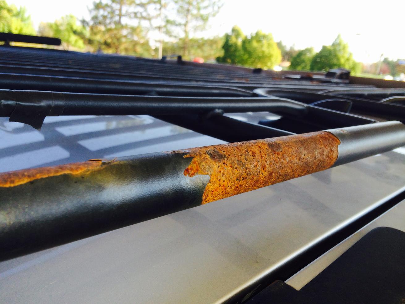

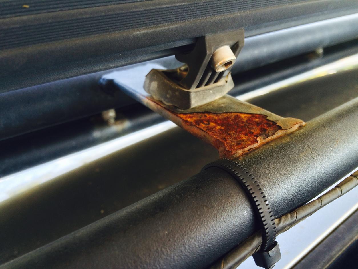

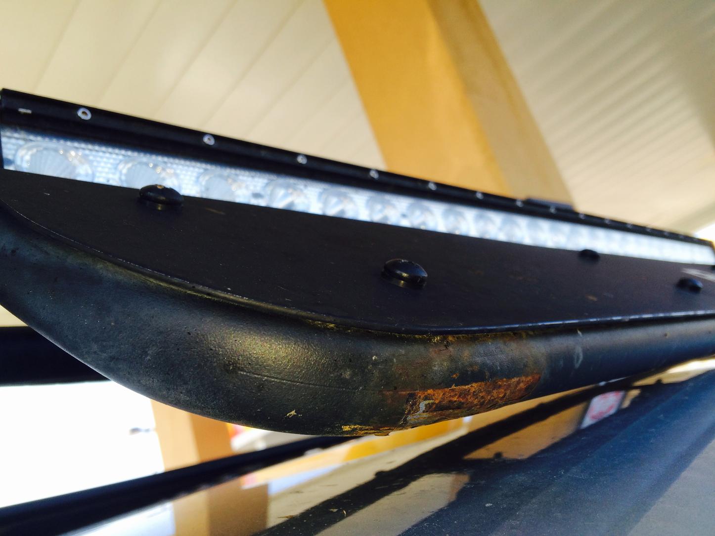

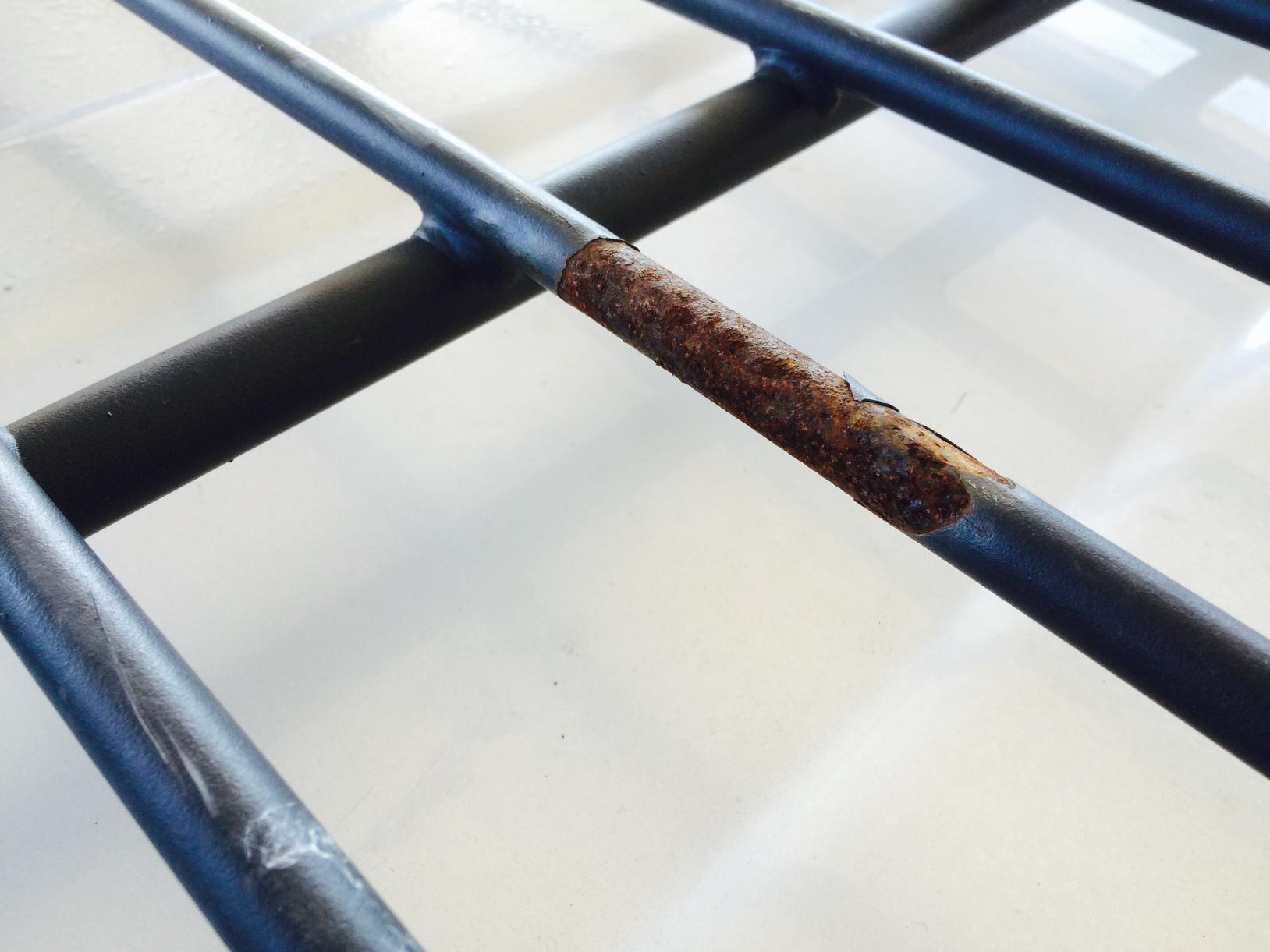

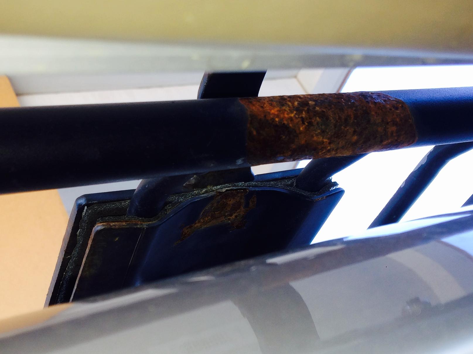

I would stay away from Bajarack. I've had mine for a few years and it's rusting everywhere. It's also bowing in the center from the weight of an RTT. As I can see from the Trooper, you tend to use your vehicle so I would assume that it would see some abuse. I would go with something from EQUIPT or Frontrunner. All in all, the Baja has done it's job, however, it won't last another season.
Hmmm, it looks pretty good up there, not as nice as it did on my Trooper, but still, it works! Interesting that the 4Runner has a narrower roof line than my Trooper, which is overall a bit smaller.
