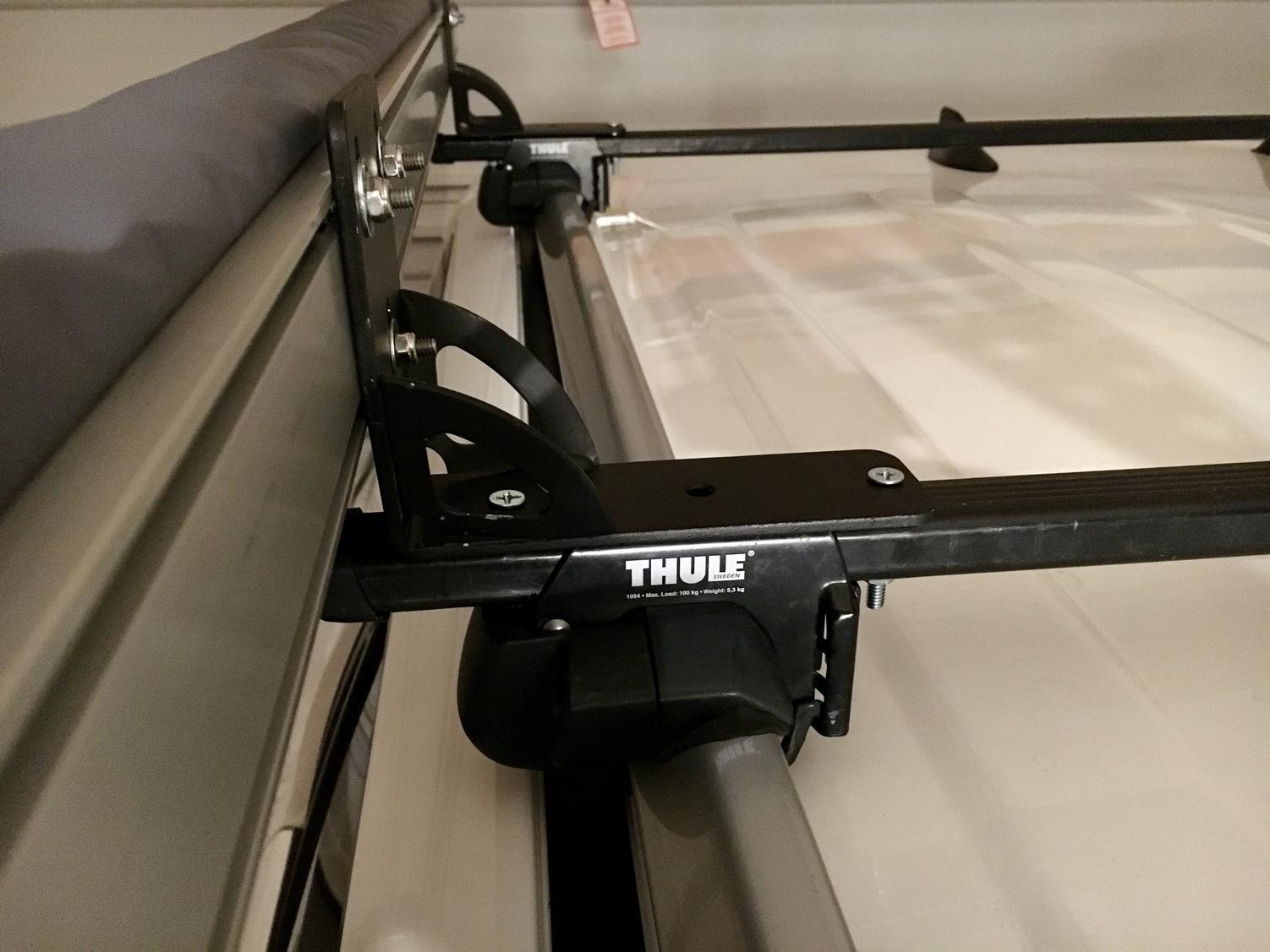

TO ADD MY TWO-CENTS WORTH. The roof racks of the T4R have enough strength to support an RTT, it is the factory cross bars that are NOT. I added a Thule clamp-on with square cross bars rated at 220KG and added my RTT. It is solid with no flex, and I have not worries it will handle the on and off road stresses placed on the RTT or the mounting. The Thule set up as an old one I had on hand, but new ones are a couple of hundred or less on sale. I am not in disagreement with the idea of a basket or flat platform (Pioneer or others would be my preference), only that the cost can be a lot less than the 1000's stated above to get you started and out in the wild.
