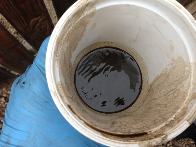

still the engine roughness. today i installed a new fuel filter. the stuff that came out of the old filter was watery brown mud. gritty brown mud water. it was shocking. Thank You Filter. You have been doing your job. I commend you for your service.
Besides the immediate obvious improvement in throttle response, acceleration, and overall engine performance, I notice the roughness is greatly reduced. Substantially reduced. Obviously reduced.
I surmise the filthy filter was impeding fuel flow within that RPM range. The fuel demand of the engine below 2000 RPM was low enough that the impeded flow through the dirty filter wasn't an issue. But when the RPMs start increasing as 3.4 liters of V6 start producing some real power to get our 4000lbs of truck really moving, it demands more gas at a faster rate. it is gulping that stuff down. the straw it is sucking through is clogged, so it sucks harder. no matter how hard as it sucks the dirty filter limits the flow. It cannot get the quantity at the rate it needs. I think the engine is trying so hard to do its job with an inadequate supply of fuel that is is simply stressing out. its trying but just can't quite get it done, so it isn't running smoothly. It is stressing and straining and experiencing disharmony.
Or not. Just a theory. Not sure how to explain the roughness diminishing above 3000 RPMs, which seems to put the lie to my ill informed conjecture.
But I'm telling you, so much smoother with a new filter. Ill try to post of foto of the vile bile spewed by the old filter.

Good post. I had changed my fuel filter last summer but i am glad it helped.
