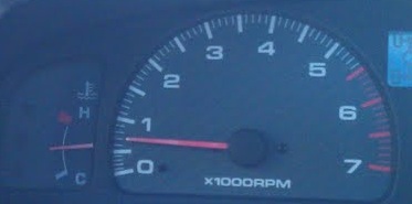

I'm getting a rough idle/vibration around 650 RPMs when the truck is warm. It's not a horrible rattle but it's enough that it gives a subtle drivetrain vibration I notice when at idle; anyone else have experience with this?

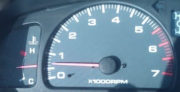

Bump up the RPMs at all and it's smooth as butter again. Truck starts/runs great with 122K, no codes, no other symptoms or problems.
I don't have it hooked to a scangauge so I can't provide the actual RPMs this is occurring at but when I'm stopped at a light, in gear, I notice it until I change the RPMs or shift into neutral.

Per the tach:
600 RPMS no AC, slightly rough idle
650 RPMS AC on- Idle is fine.

I have an '04 V8 with 108K and am getting the same rough at idle at around 650 RPMs. Like with you, if RPMs go slightly up or down, the roughness goes away. Thanks in advance for any insights.
Same here - idle about 700 RPM in drive. When in neutral idle is smooth.
Also, in drive, if I bump up 100 to 200 RPM it smoothes out.
