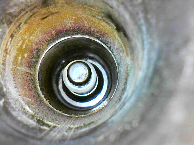

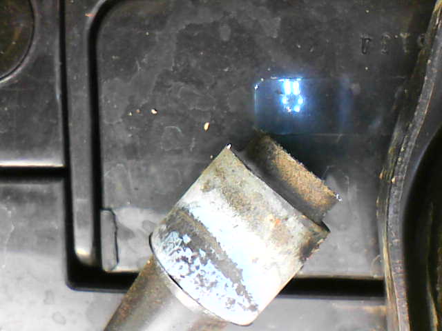

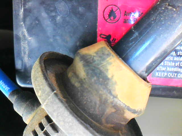

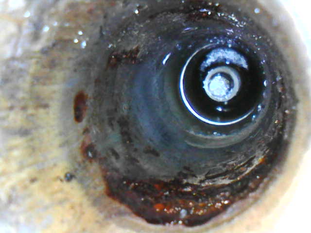

Pulled all boots and endoscoped
Interesting corrosion
Blew out all ports
(see loose boot port vs neighbor)

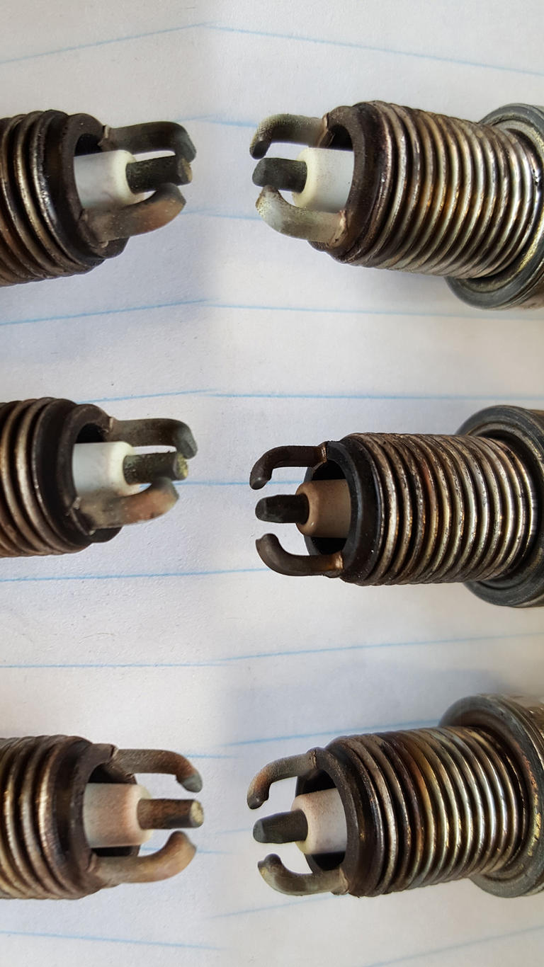

Pulled all plugs
(see pics fairly easy to tell which one didnt have boot attached)
Ordered plugs and wires, no coils as they seem to have not suffered

Those plugs defiantly needed replacing. Then the center electrode is worn in a oval shape they are done.
