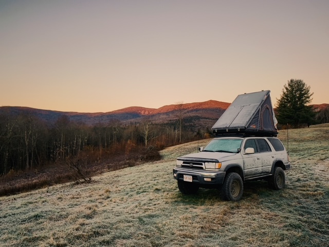

I have a Roofnest Falcon on a Sherpa MK1 rack with a 4xinnovations rear bumper with swing full size spare (33" e load general grabber). It is on Dobinsons C59-210v rear springs.
Still handles great, but man, when the tent is off, it feels like a race car handling-wise LOL.

Haha dude, I bet. I guess I'm glad I don't take mine off cus I'll never know the difference! :P Mine's a Roofnest Sparrow. You ever been tempted to put a front bumper on too? Thanks for the reply, and sweet rig
I keep mine on all year for now as well. Had my old tent off due to a recall and it felt amazing during that time.
I have definitely been tempted to put on a front bumper. However, I would most likely want coilovers for the adjustability from the added weight, and I'm also hesitant of throwing even more weight on the lower balljoints so I haven't done anything yet. Maybe if I ever crunch the front bumper it will tempt me more.
