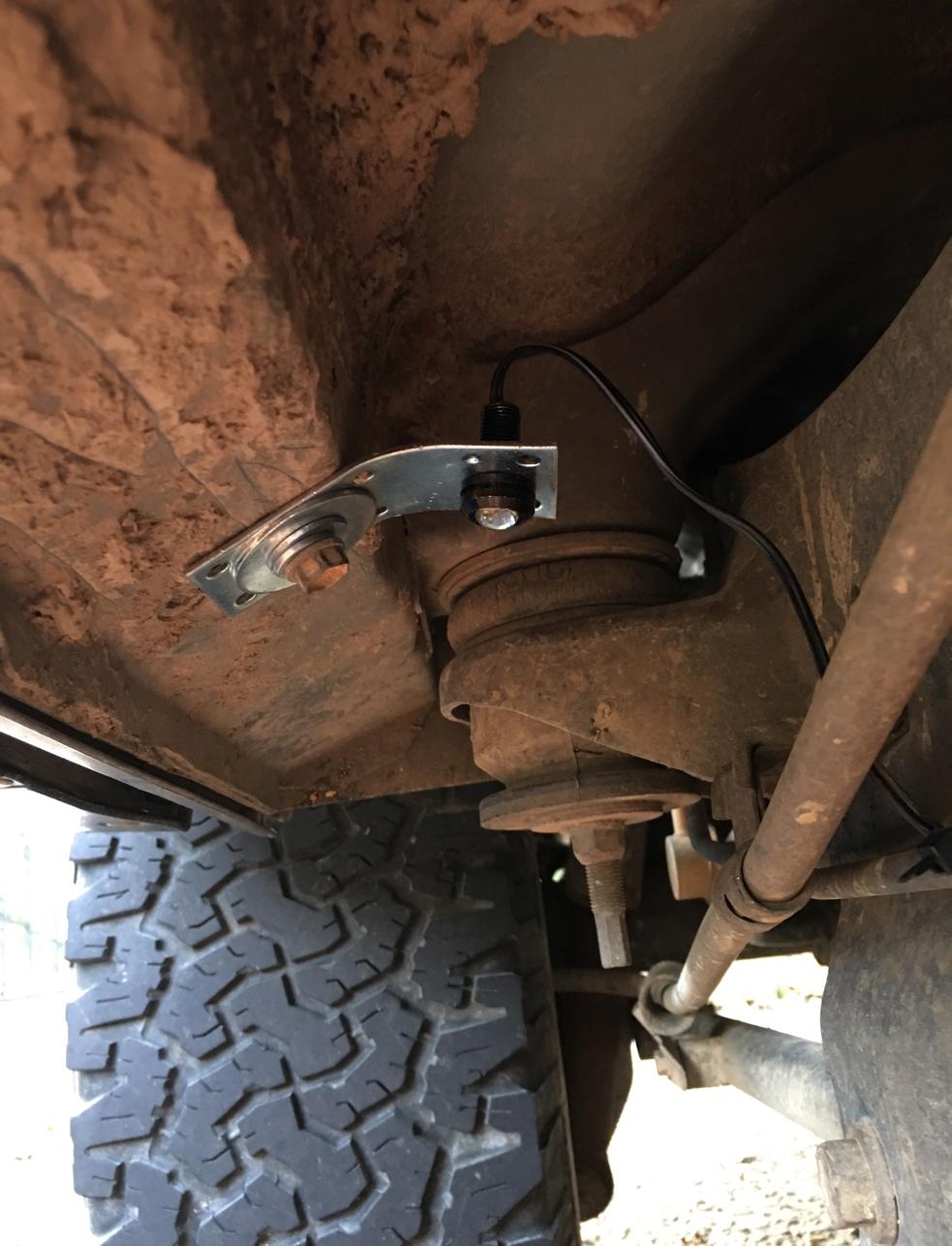

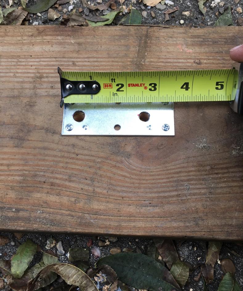

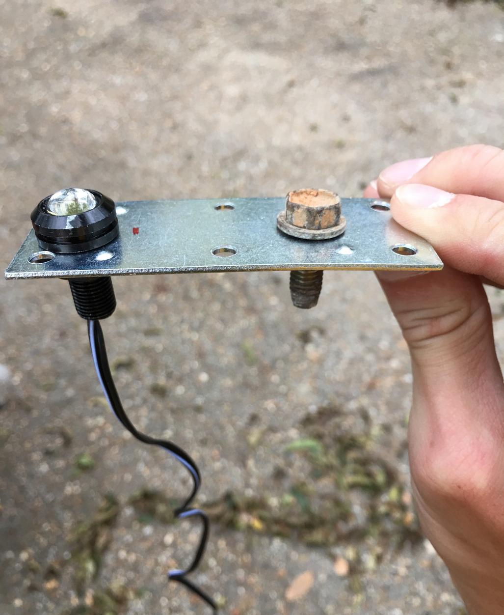

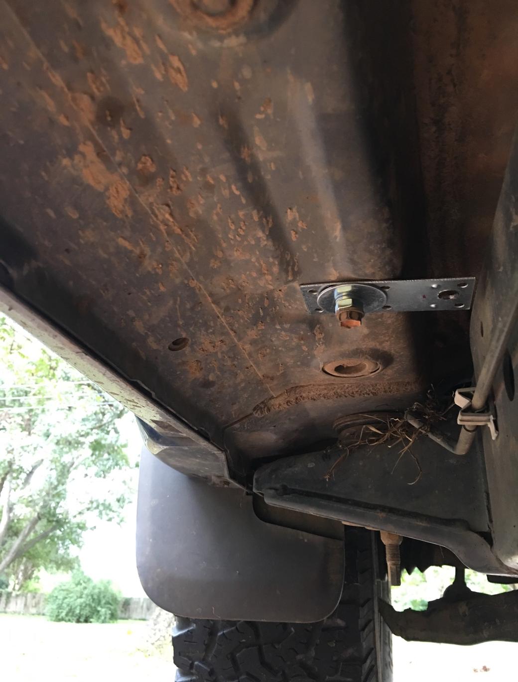

Low and behold, I still had all the bolts from when I took off the running boards 8 years ago. I picked up some 3 1/2” by 1 3/8” brackets and drilled holes for the bolts (5/16 bit for the original bolt and 3/8 bit for the LED bolt). Since the bracket came with screws, I screwed the bracket into some wood to drill the holes through.

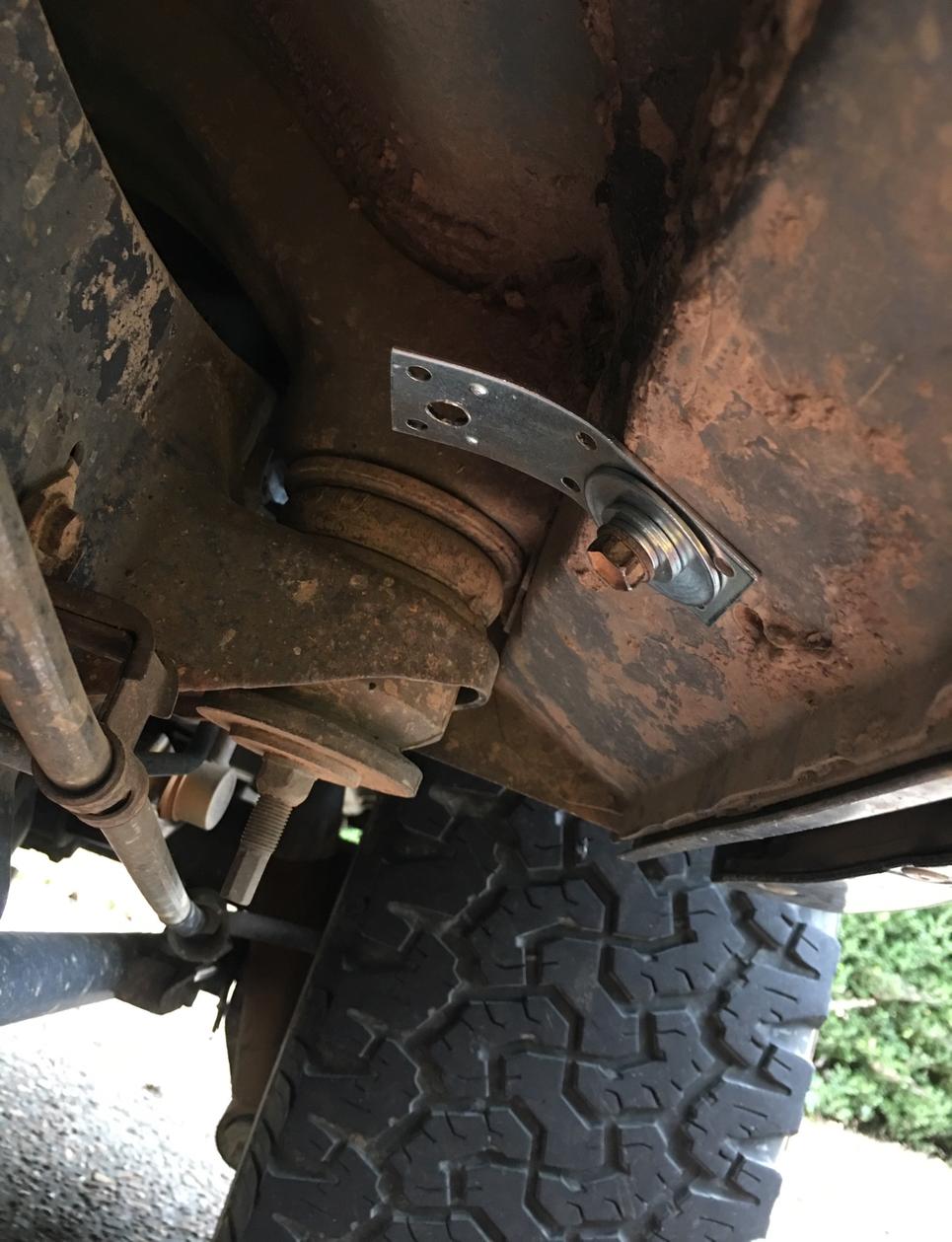

I needed a few washers to put on the original running board bolt (I had to scrounge around in my tool box). The front bracket sits relatively flat, but the rear bracket had to be bent a little so it wouldn’t aim the light underneath the truck.

I ran the wires down the frame and spliced them into the existing wires for the running board lights. It took me longer to strip those tiny wires than it did to bolt everything on. I bent the brackets a bit once the lights came on to line them up. I wish the beam angle was a little wider, but all things considered...I’m happy with it.

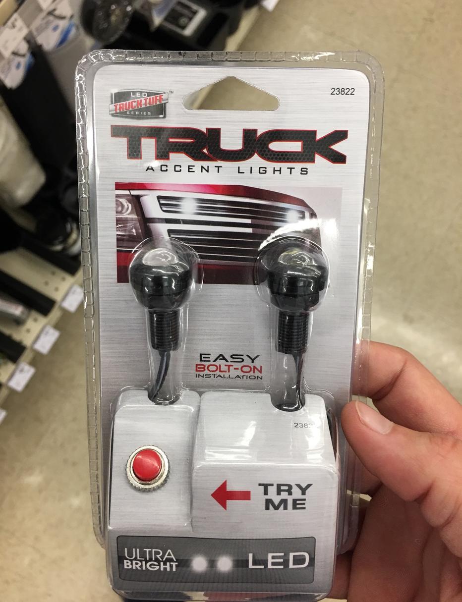

Thanks! Yeah, they’re surprisingly bright for such a compact light. If they hadn’t had the push button tester in the packaging I probably would have passed them by. They were super convenient to install since it’s essentially just a bolt. I wanted to mount them directly on the frame or body, but realized it’d be much easier to run the wire doing it this way.
