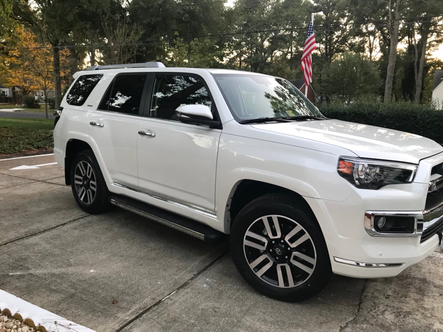

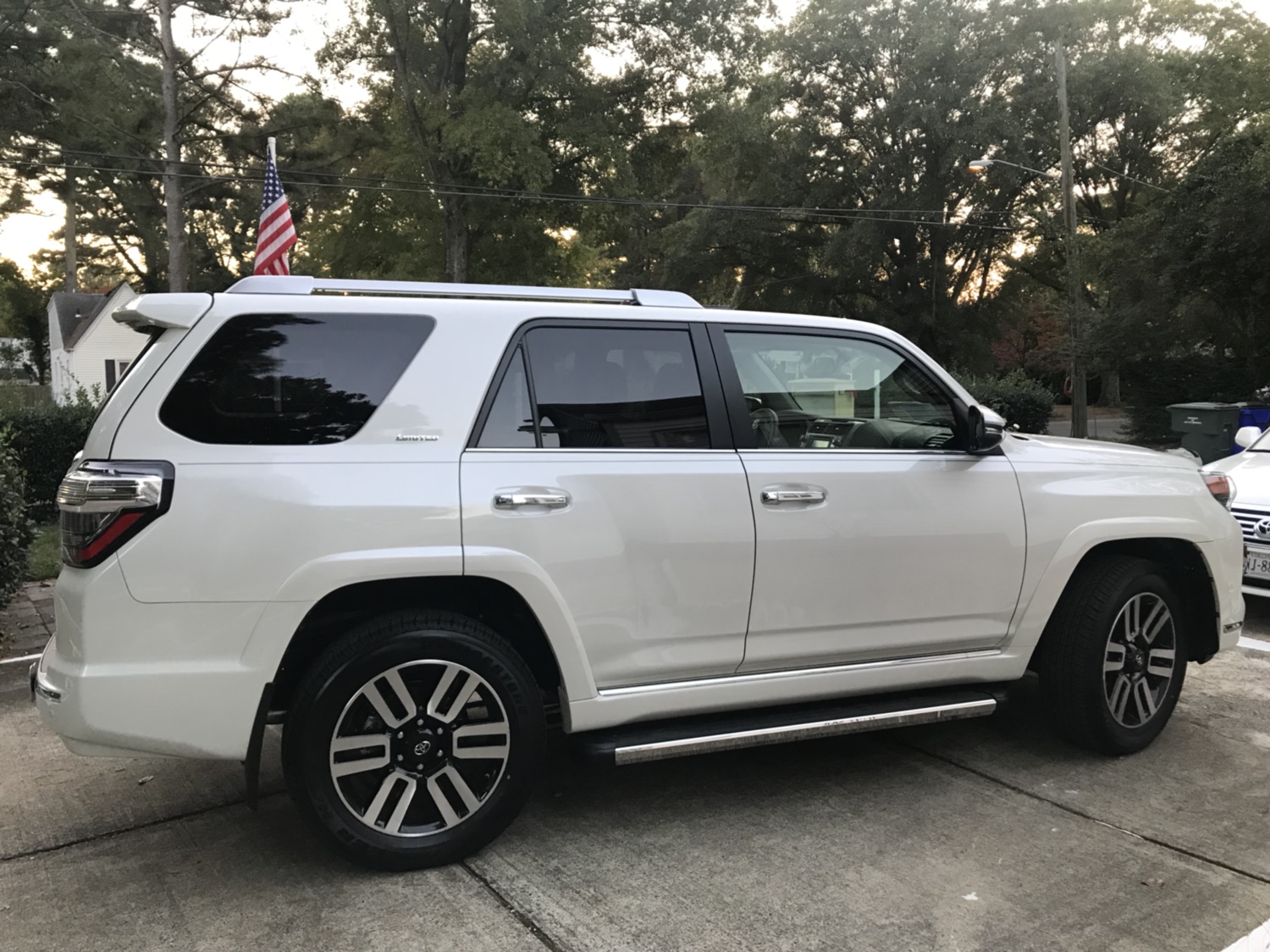

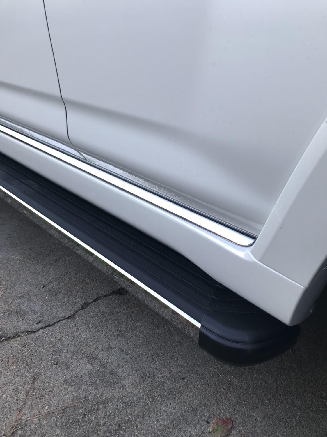

Thank you all for your help and suggestions. I just bought the rails for the limited edition with the chrome accents and it fit like a glove. Didn’t have to take off the rocker molding and was able to use the existing holes to mount. The bolts that came with it were a little longer to compensate for the thickness of both brackets.
Having done all that I think the boards are a little to thin to get a good full step on them. It would have been perfect if they stuck out about 1-2 inches outward.
