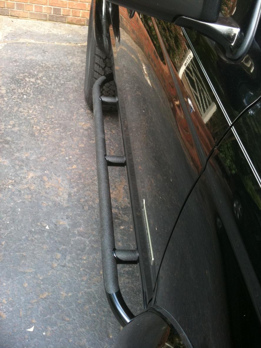

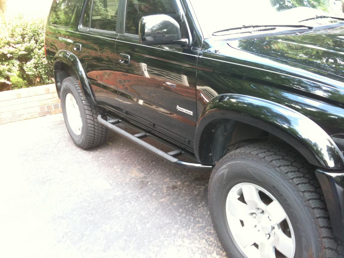

Sliders will give you protection when wheeling and supply a step.
Most people angle the outside tubes of sliders up but you don't NEED to. They can be mounted level to allow a better step.
opted for Sliders and as stated above did not angle them except for 1 degree up.
make a nice solid step, does not sacrifice ground clearance, looks good and has already saved my doors from 2 Cadillac doors in parking lots.

nunyabiz, are those custom or did you order them from somewhere. I really like the way they look.
so anytime i see sliders on a 4runner they are aftermarket?

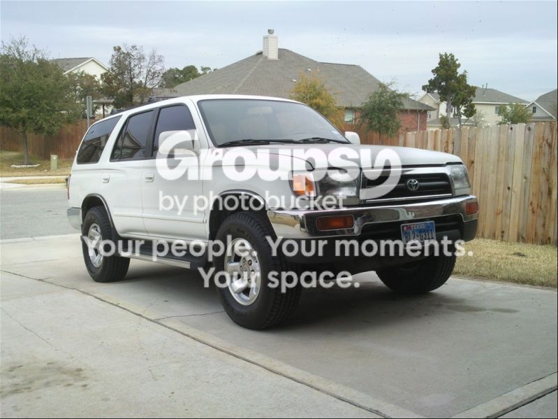

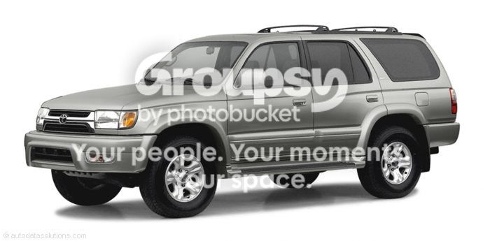

1. Factory running boards. These run along the bottom of the sills and are either black or painted to match. They are molded into the body giving it a more streamline look.

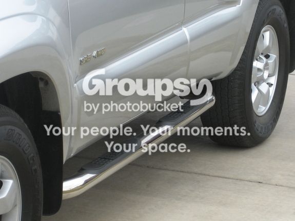

2. Nerf bars. These are aftermarket bars that run along the bottom. Usually chrome or black. Purpose is for looks and to add a step up to get in or to get to the roof rack.

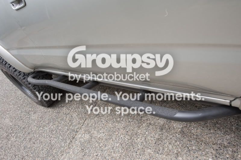

3. Sliders. These are made from round or square tubing. The main purpose of sliders is to protect the bottom from damage (basically an extension of the frame). They can also serve as a jack point as well as a step up.
Thanks.
They are made by Trail Gear, 67" long.
Bought them from Scottie at Addicted OffRoad, they were $176.00.
They come bare metal, need to be welded on and then I primered and painted them then added the grip tape.
