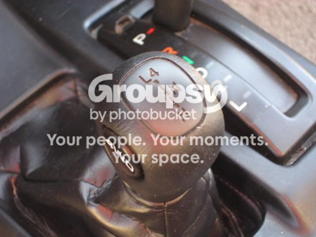

'96-00 SR5s and 5 speed models.. (standard "J" t-case shifter)
1st position: 2HI
2nd position: 4HI (locked only)
N
3rd position: 4LO
96sr5tcaseshifter.jpg~original

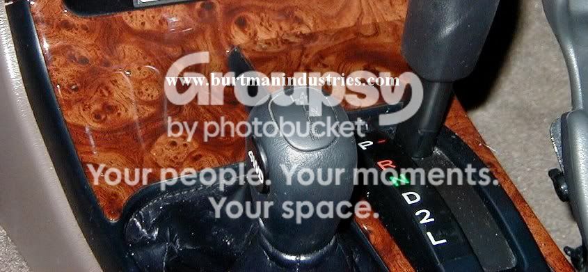

'96-98 Limiteds...
1st position: 2HI with a push-button on the shifter to engage 4HI (locked only)
N
2nd position: 4LO
96limitedtcaseshifter.jpg~original

'99 and '00 Limteds...
1st position: 2HI with a push-button on the shifter to engage AWD (aka 4HI unlocked)
2nd position: 4HI locked
N
3rd position: 4LO locked
00limitedtcaseshifter.jpg~original

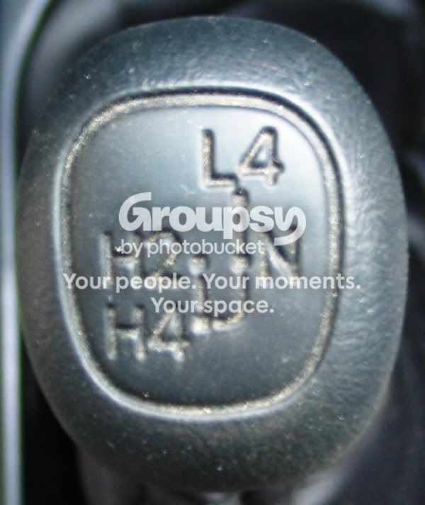

The '01s and '02s...
1st position: HI range with a push button on the shifter to choose between 2HI and 4HI (locked or unlocked CDL is controlled by a separate switch on the dash)
N
2nd position: 4LO (locked or unlocked CDL still controlled by the dash switch)
01tcaseshifter.jpg~original
^^ '1s/02s have basically the same shifter as the '96-98 Limiteds, but with the addition of the center diff locker switch (below)..
