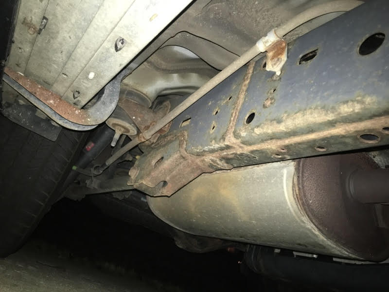

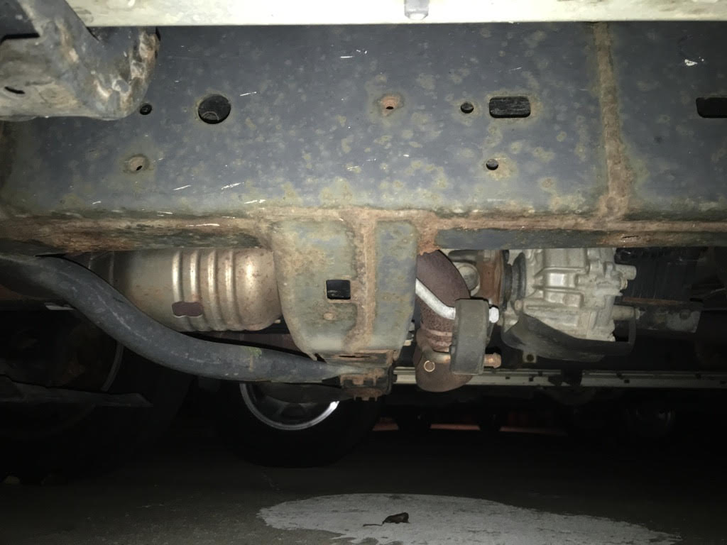

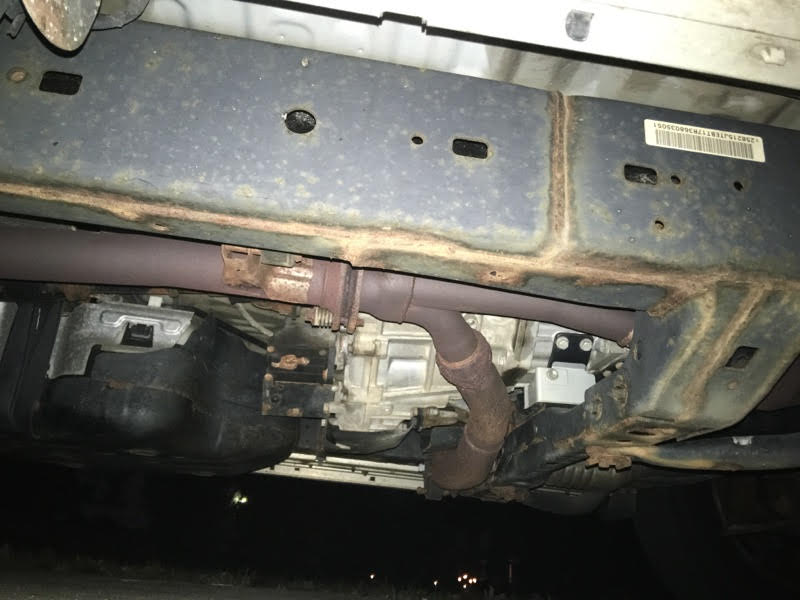

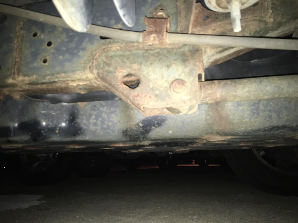

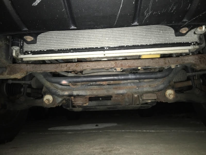

Looking at a 2006 Limited 4x4. It's been in North VA all it's life, so I asked for some undercarriage pics. It will gain more rust where I live over the years.
How bad is it? Would you be worried? It's a pretty good price, but not a steal.

Not perfect, but really not that terrible either. The welds will have surface rust on any 4runner frame, it's the other spots on the rear lower control arm links and front rad crossmember that need more attention. Do you plan on doing any sort of frame restoration? Wire wheel, phosphoric acid, enamel paint, inner rail coating would make that look new and last much longer. Lots of work but if the deals worth it and your labor is free (like mine to myself) then I say go for it.
Not too bad but I'd recommend getting it sprayed annually with Krown or similar to stop it and prevent any further progression
No too bad

Looks like the undercarriage of my truck! A little bit of elbow grease, and some time should take care of that.
The front skid plate is missing and the exhaust looks like it has been patched up in the last picture.
Looks normal for a northern vehicle. The southern guys might tell you to walk away but they just don't know what life is like up here. Regular oil spraying was a good suggestion. Be prepared though, when you see DIY threads on here saying certain jobs are easy - those bolts are gonna give you a bad time.
