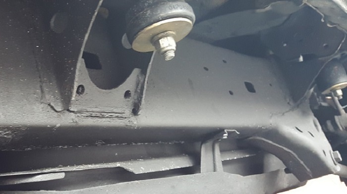

Overall in the salt belt, if you don't do seasonal rust proofing coatings, like Fluid Film, petro, etc, rust will be doing its thing. I do a full spray of undercarriage, inside frame, inside rockers, inside door bottoms, inside hatch bottoms, inside hood lip. Here's a pic of my 20 yr old frame original paint in salty Massachusetts using only WD40 seasonally. Its all black and solid.
Wow that's amazing for a frame that's been in a salty area! I was pretty surprised at how small of a can POR15 comes in and how thin it was. But it goes along way and bonded excellent to a surface that was just power brushed.
I am insanely shocked by this picture, I literally CAN NOT believe my eyes!!! Am I to believe, that you have ONLY used WD40? ever? Are you the original owner? How many miles on your rig? Garage kept? Daily driver?
Sorry I am literally shocked...
I bought it at 139K, there's about 355K on the chassis now. I drive about 1,000 miles per week. Never garaged, driven daily, no matter the salty roads or not, I never wash the undercarriage.
I do my WD40 treatments twice seasonally, once 1st snow, then another for the home stretch about February. It does really work, and yes I only use WD40, see my write up -
