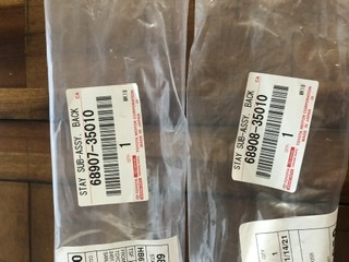

I also need replacement rear lifts. Anyone want to post up the OEM part # for them?
Here ya go:
Can be tricky looking up the numbers on some Toyota dealer’s websites. Some don’t use the dash in the number. May be easier to input “hatch lift support” and match the numbers up from there. That was my experience. Or just google the number!

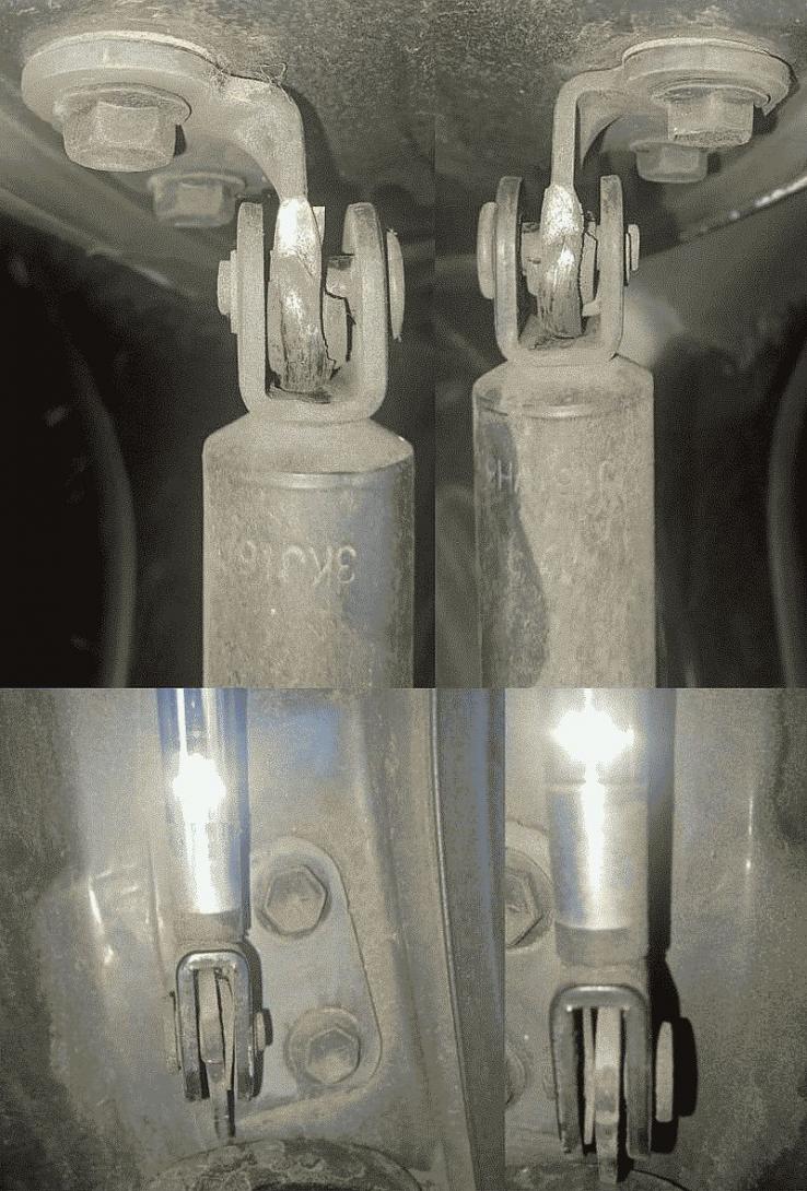

I'm confused.
Can someone who has bought the parts clarify which strut supports come with these "bushings" and "eclips" that people are talking about. Are these bushings and eclips on the top or bottom of the hatch strut connections?
I can't see any bushings or clips in mine which I think are the original hatch supports.

I'm confused.
Your bushings are gone (get a little clunk and movement if you push up on the gate when it's up?, that's what the bushing eliminates), and the e-clip is clearly visible on the top photos, the side with the 2 mounting bolts that hold the bracket to the hatch.

I'm confused.
E-clip holds the pin in place... one for each of the 4 pins... top and bottom of each strut... be careful they will shoot a long ways and be gone forever!
Your bushings are shot... can’t take credit for the idea, but the bushing can be made from plastic cylinders available at the big box store.
