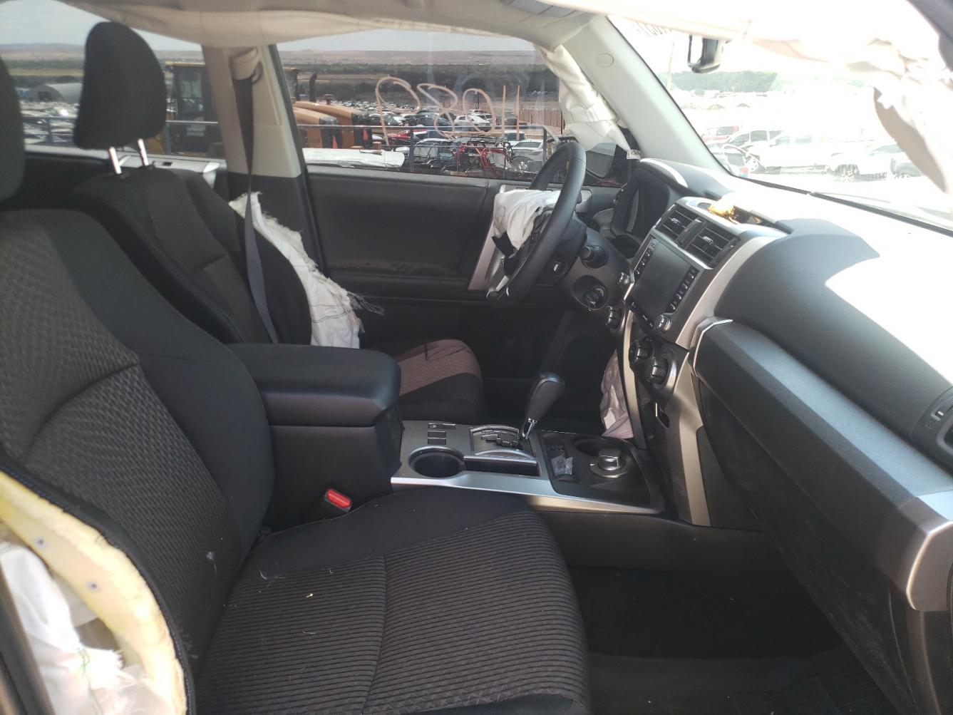

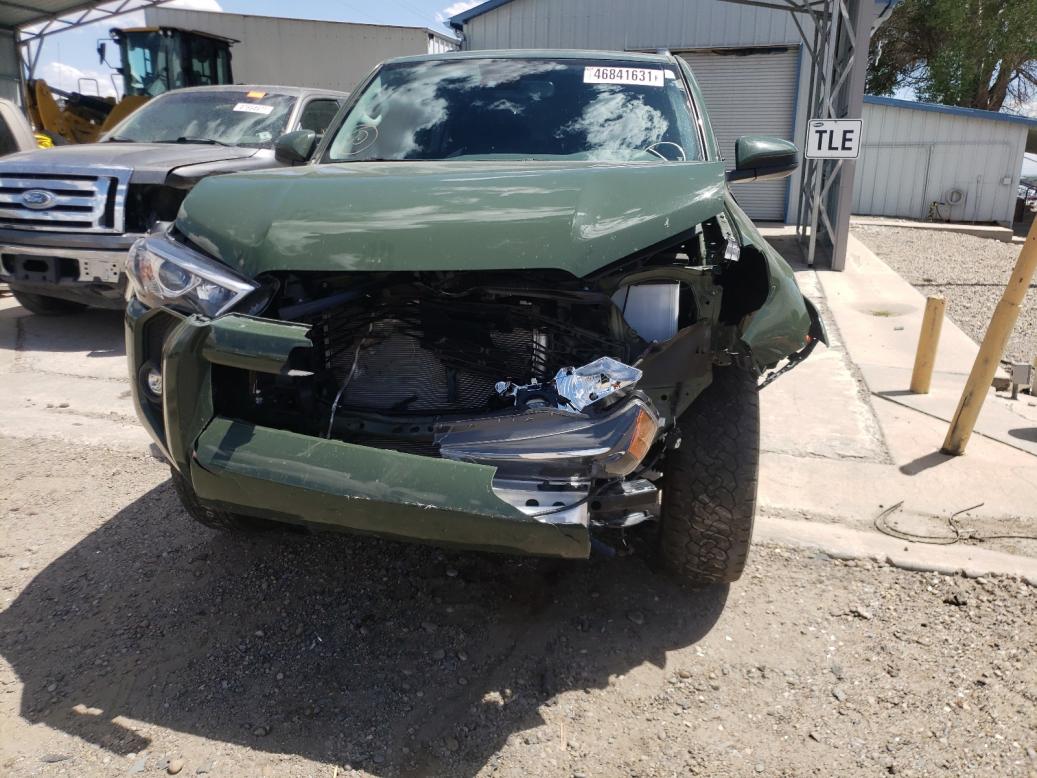

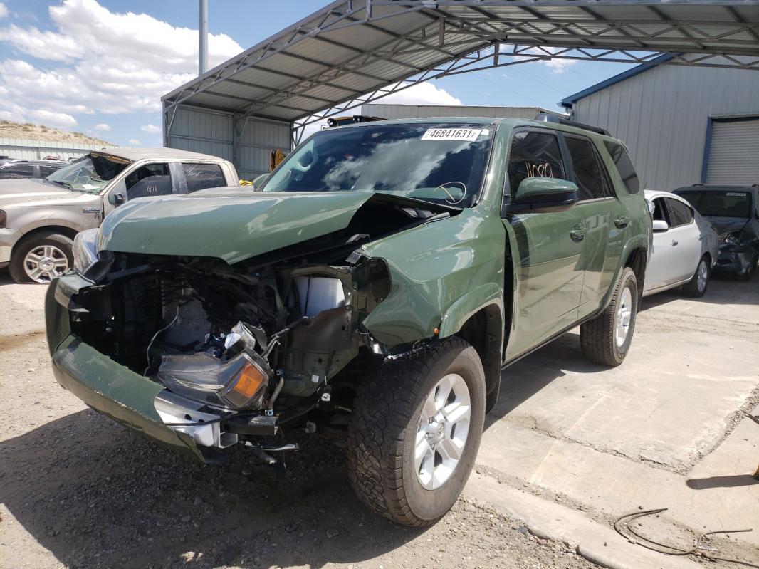

Absolute Home Run with your first post Mike!!! Thanks so much. Look what I found...
Ah yes, it was an SR5 - and not even an SR5 Premium. I'll bet some unsuspecting person buys it and can't believe they snagged a TRD Pro for so little. Nice work!
It's a trail special edition actually. A dressed up SR5. Looks like someone snagged the trail wheels, rack and cooler before it went to the auction.
