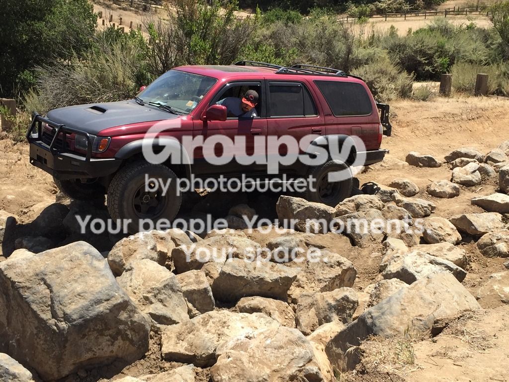

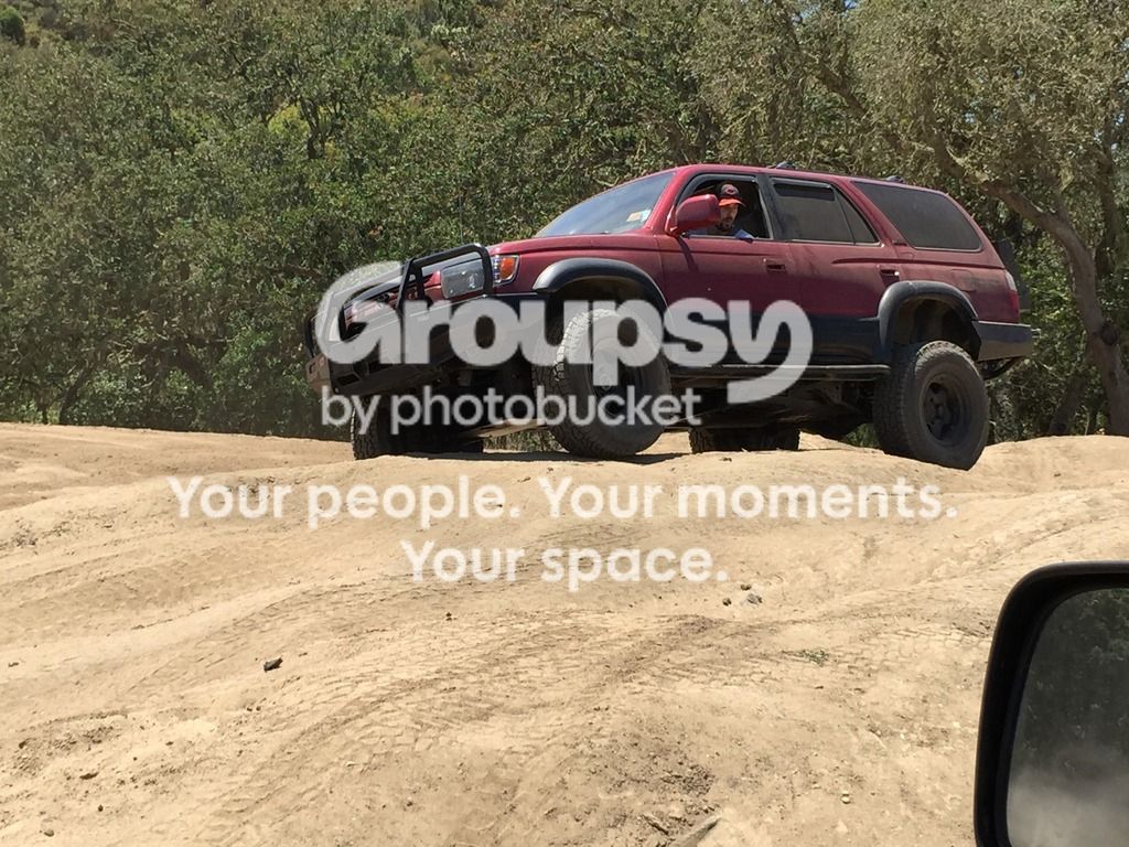

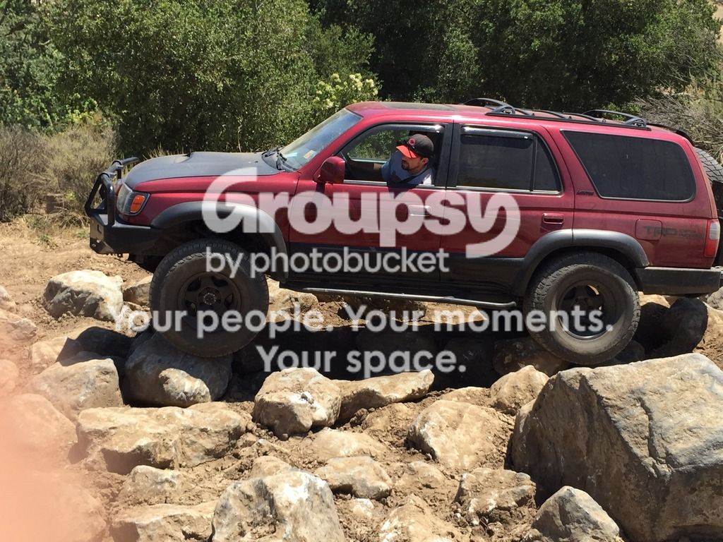

Front skid, rear bumper, general awesomeness.

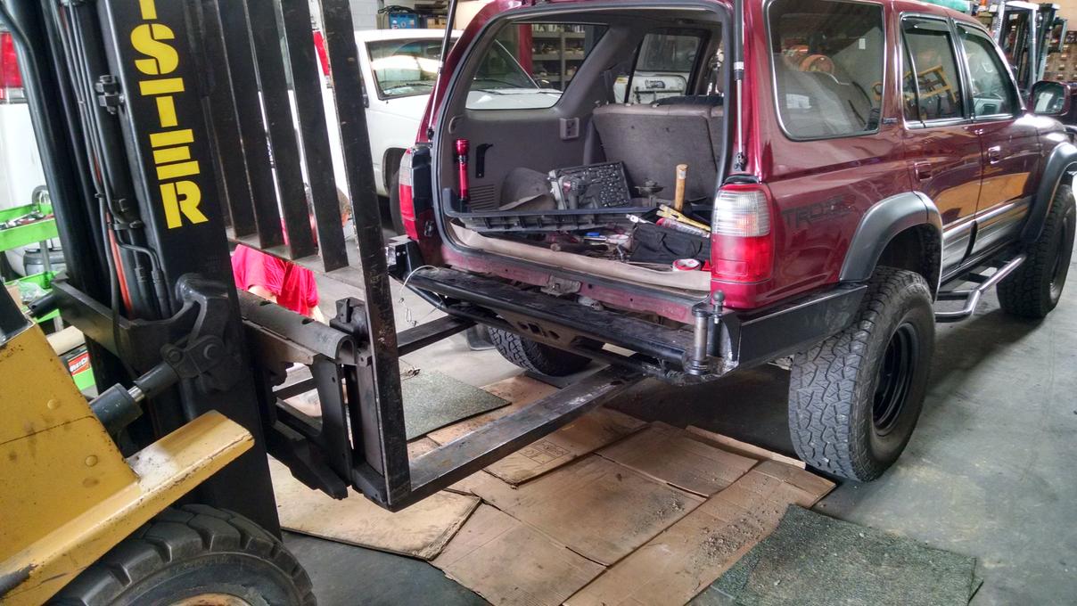

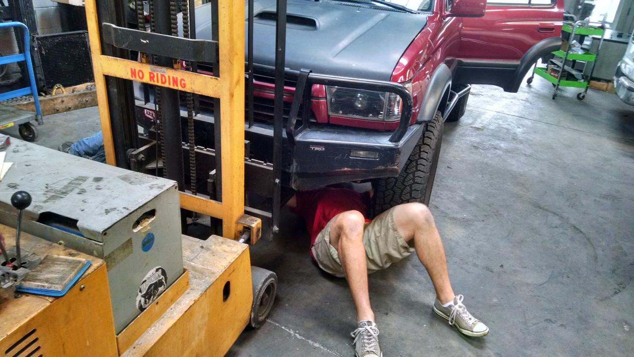

As shown above I finally got the bumper up from [MENTION=50454]bricebones[/MENTION] and installed. Giant thanks to [MENTION=100687]Konkordmusk[/MENTION] and his co-worker Don. Caleb not only picked the bumper up for me, but also invited me to his work so I could use the fork lifts and welder while there. As you can see in the picture above, I had quite a bit of mud built up in my bumper and frame that rained down on us when we were removing it. After that it really was quick to install the bumper as the forklift did all the heavy lifting.
I was going to install some OME 861's when I put the bumper on, but decided to wait as I didn't want it to be too tall. Right now I'm at about 23.5" in the back and 23" up front. I'm going to be bumping my front up a bit more soon when I install my 650lb springs, so I don't want to be bro leaning. Might just install a couple 10mm OME spacers to see how it brings up the back. I'm happy with the superflex, but I'd like a bit more height out of the back when unloaded.
I also worked on a skid plate I had bought off Vin (@scsperformance). He had bought the skid a long time ago and it never fit his Tacoma as it was about 2" too short in the front. Not sure if it was bent wrong or what, but he gave me a good deal and I figured why not. I ended up getting a 2' section of some 2x2 square tubing and had Caleb weld it to the skid and cut some openings in the front to access the bolts. Pretty goofy, but it works and I have very little into this skid so fine by me.
Mocked up and 2" short.
Caleb doing his work!
Installed

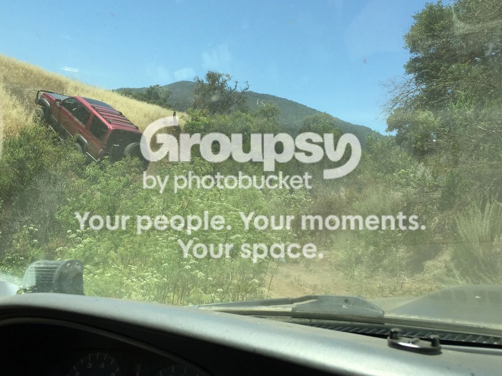

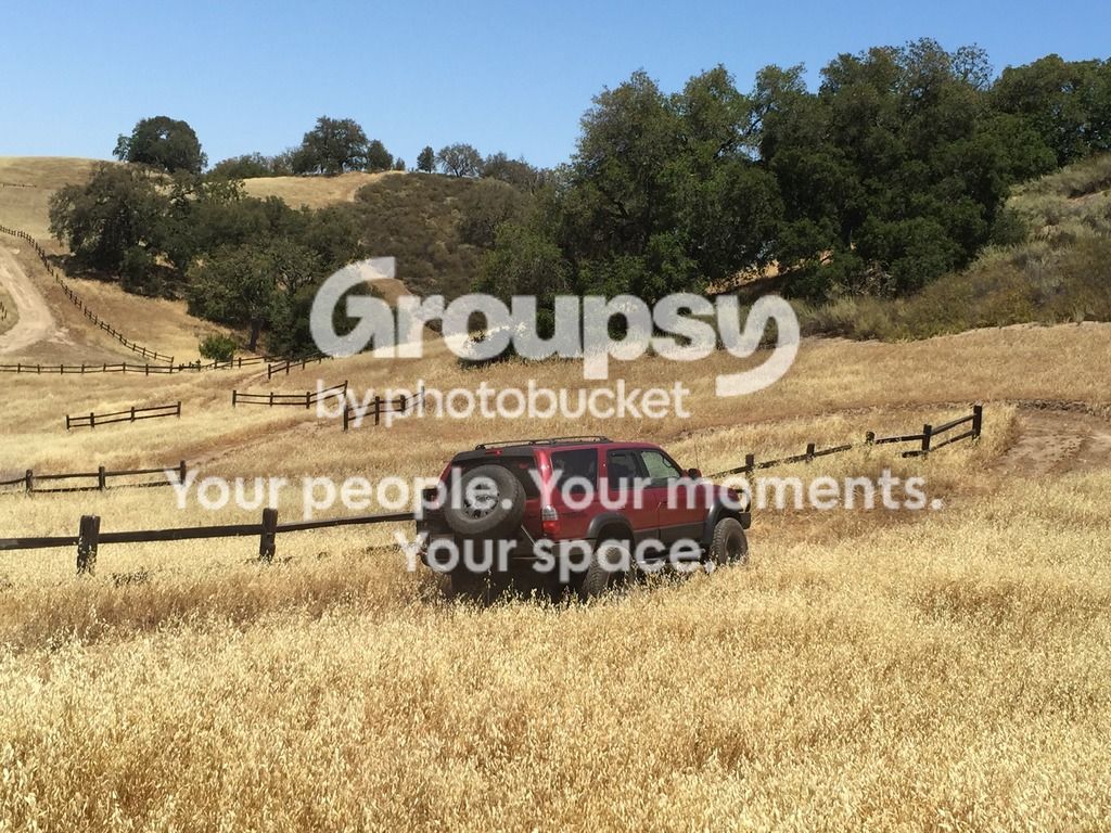

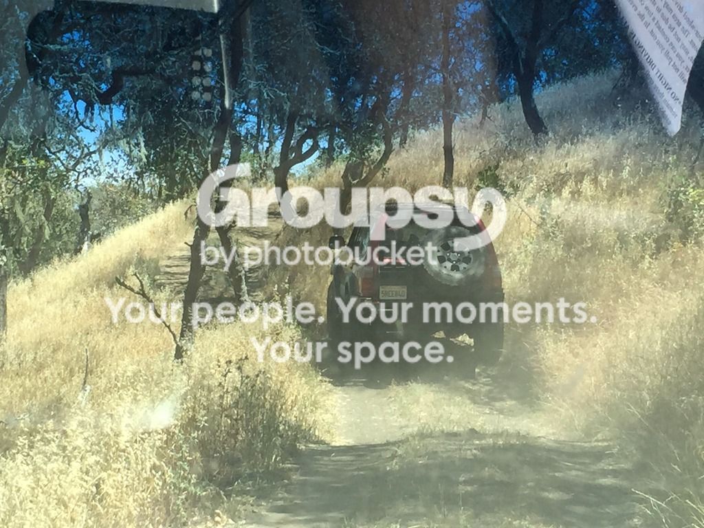

We were supposed to go to Slick Rock, but it was supposed to rain and we didn't want to risk it. Instead we went to Hollister for a shake down run with the new stuff. We had a blast and was able to take my nephew out for his first wheeling trip. Caleb's friend has all the pictures of my 4runner so I will upload those when I receive them.
Tire is at such a big angle. Any way to make it more vertical to get it closer to the hatch?
