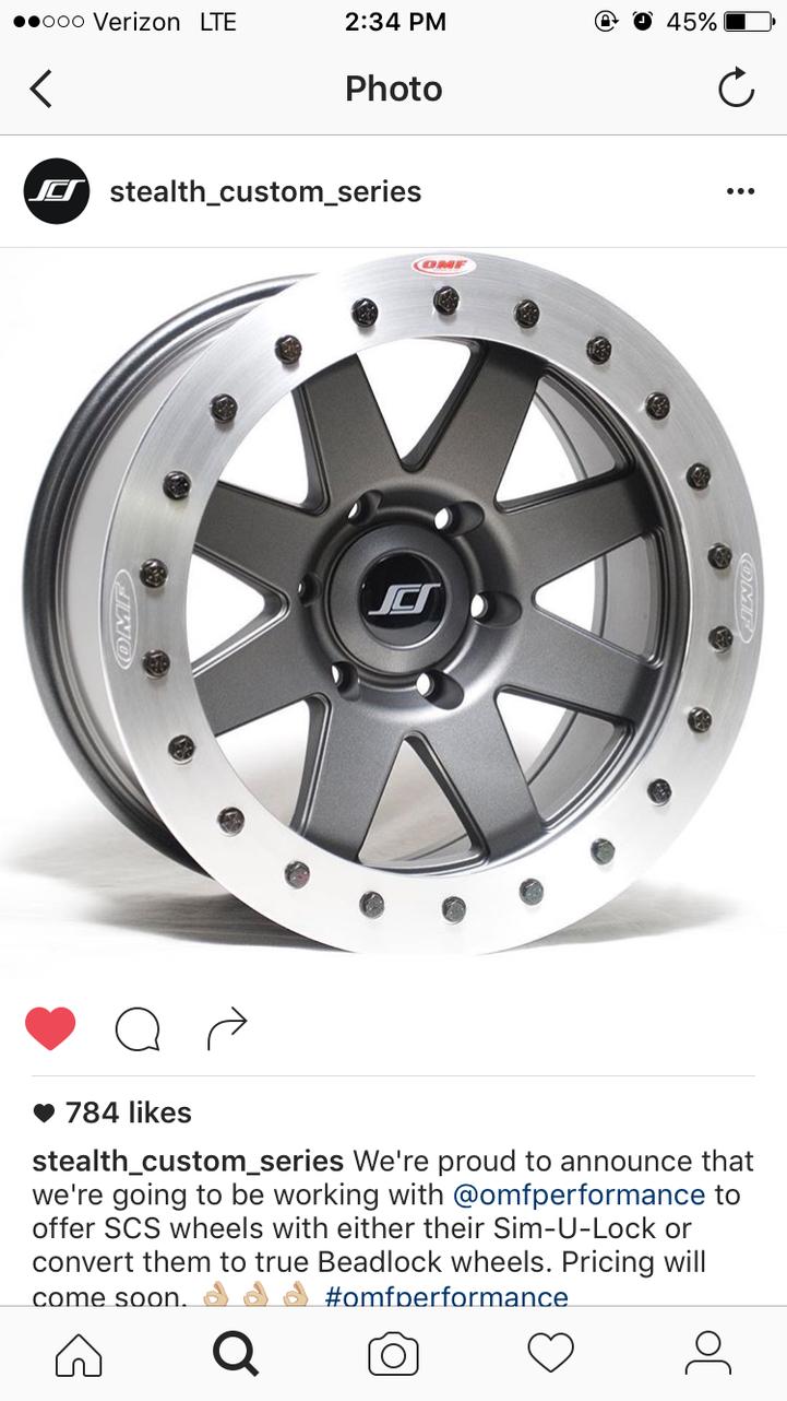

Thanks! They are the 16x8 matte gunmetal sr8's. Here is another option that will come in the future, if you like this idea better. I really like this look

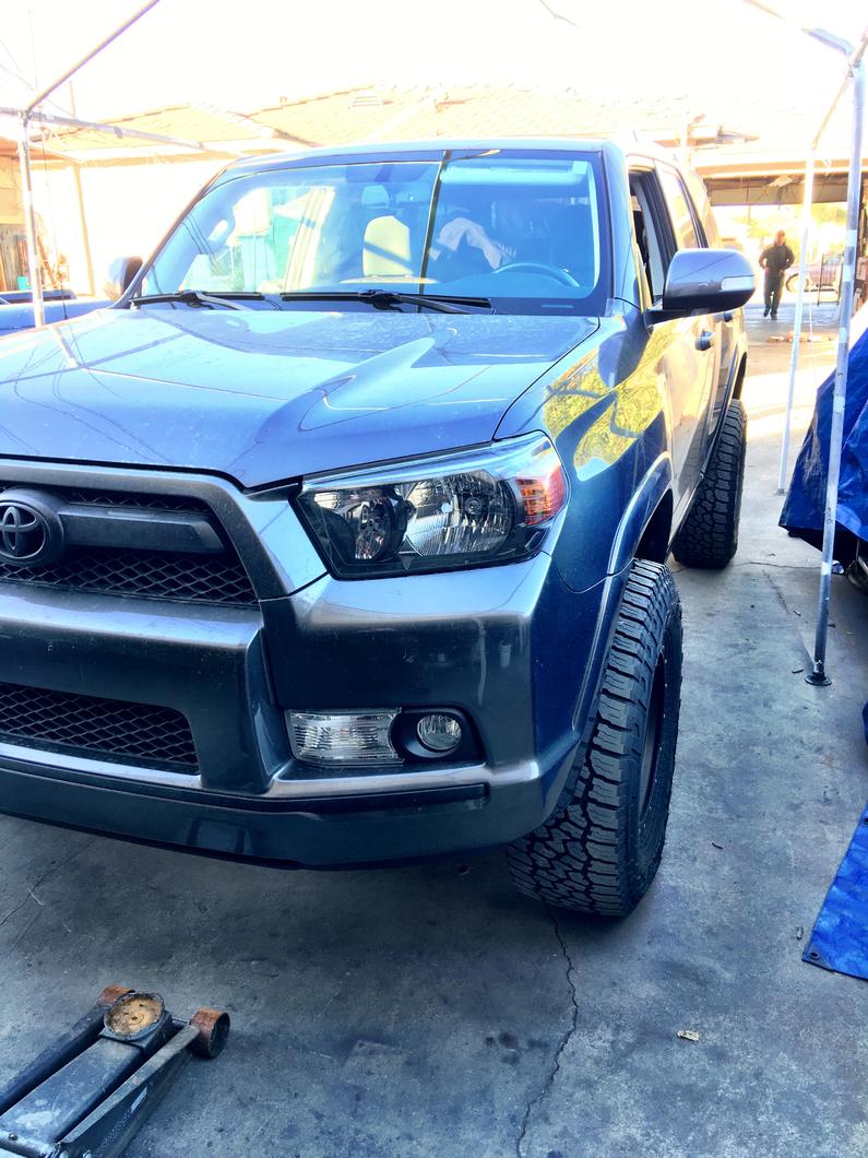

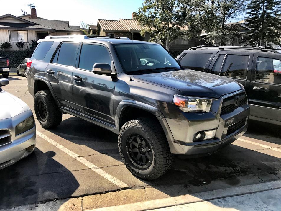

Anyone running these in their 5th Gen's with 1.25" spacers on an 3 inch lift, OME specifically? Wondering how they sit, whether cutting was required, mods to mud flaps, etc...Mine are shipping today or tomorrow and trying to get details sorted before taking it to Slee. It's riding stock right now, but will have them mount the wheels onto 285/70/17 KO2's...Any thoughts are much appreciated. SUPER EXCITED

I have them with 884 fronts and 898 rears with 1.25" spacers on my early 5th gen running 285/70/17 wildpeak at3s. I'm still on stock uca's and my caster is crap even after the lazy alignment guys tried fixing it. Moved fender liner forward and did a little trimming on my rocker panels and front bumper due to rubbing from messed up caster. I also have a bmc but it's not necessary if you plan on getting aftermarket uca's to get your caster as close as +4 or more after a proper alignment.
