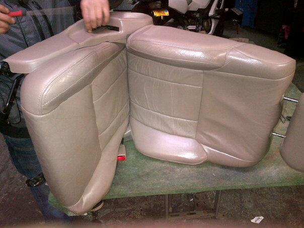

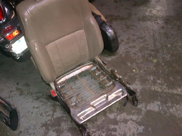

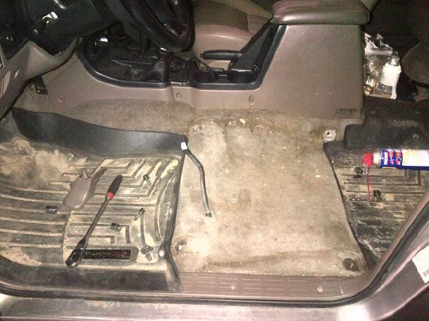

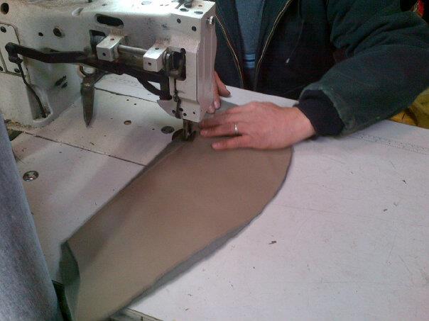

Thanks for the reply. I actually took care of it today at an upholstery shop.

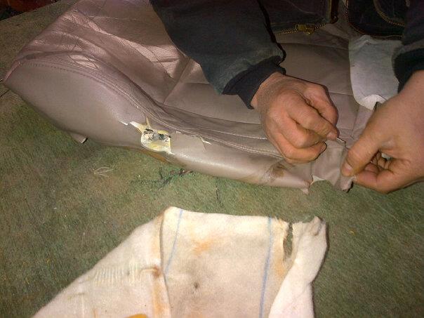

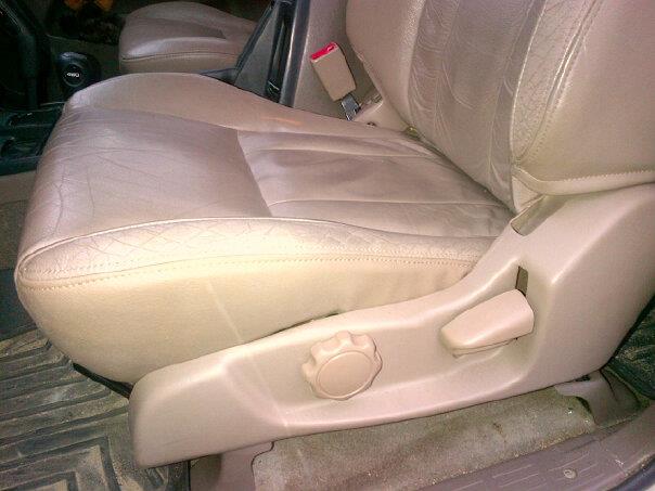

I had them repair the ripped section, the outer piece on the outer bolster of the driver seat. The color matches nearly perfectly, which is fine since that part of the seat is barely visible.

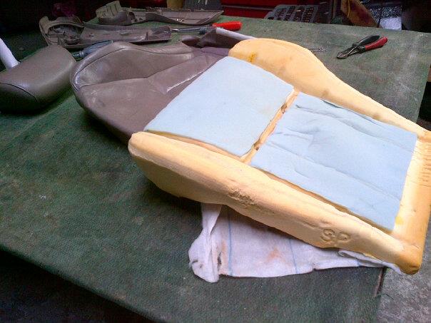

As for the cushion support, I had them swap the driver and passenger cushions. Now the outer bolsters are in the inner bolsters, and since the passenger seat was used far less frequently, it's much more supportive under my butt.
Overall I'm very pleased with the result. $200 all in.
If you want to see a pic, let me know.

Looks good Icychap -
In my '97, it's been my observation that the metal under the outboard plastic cover (in your last picture) is a major contributor to the seat cover ripping...right there above the round knob. My on-the-spot solution was to put a few layers of gorilla tape over the sharp metal edge.
