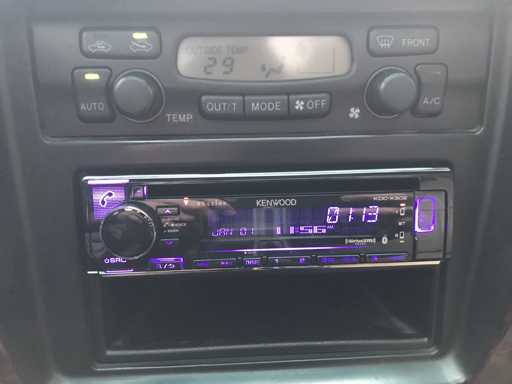

I got tired of the awful old JVC CD player with no aux input. Car Toys had a President’s Day sale with some deals so I had this Kenwood deck (KDC-X302) installed.IMG_6629.JPG
Review and details from Crutchfield here: https://www.crutchfield.com/S-A9OiVhHQOZq/p_113KDCX302/Kenwood-Excelon-KDC-X302.html
The speakers definitely sound like they’re nearly 20 years old and nothing like the speakers in my former ‘00 SR5 with the “Limited look” package which sounded surprisingly good for an older truck. Not sure if that truck had upgraded speakers, but this truck definitely needs them. Time to add to the roadmap for the truck.
