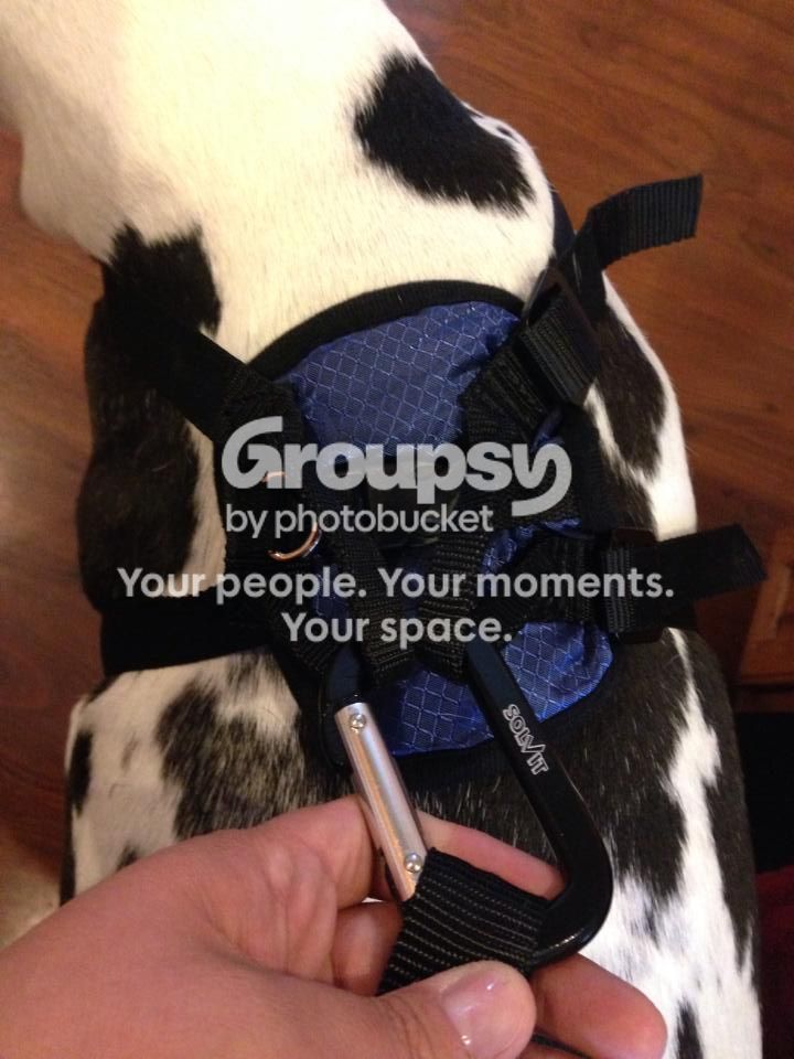

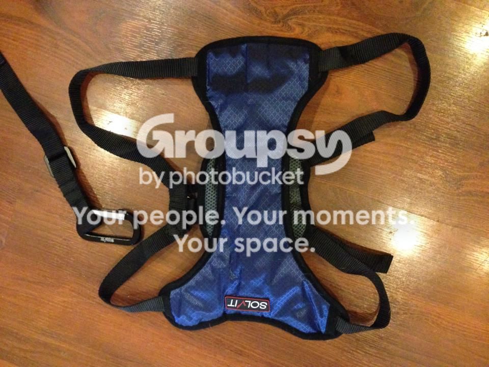

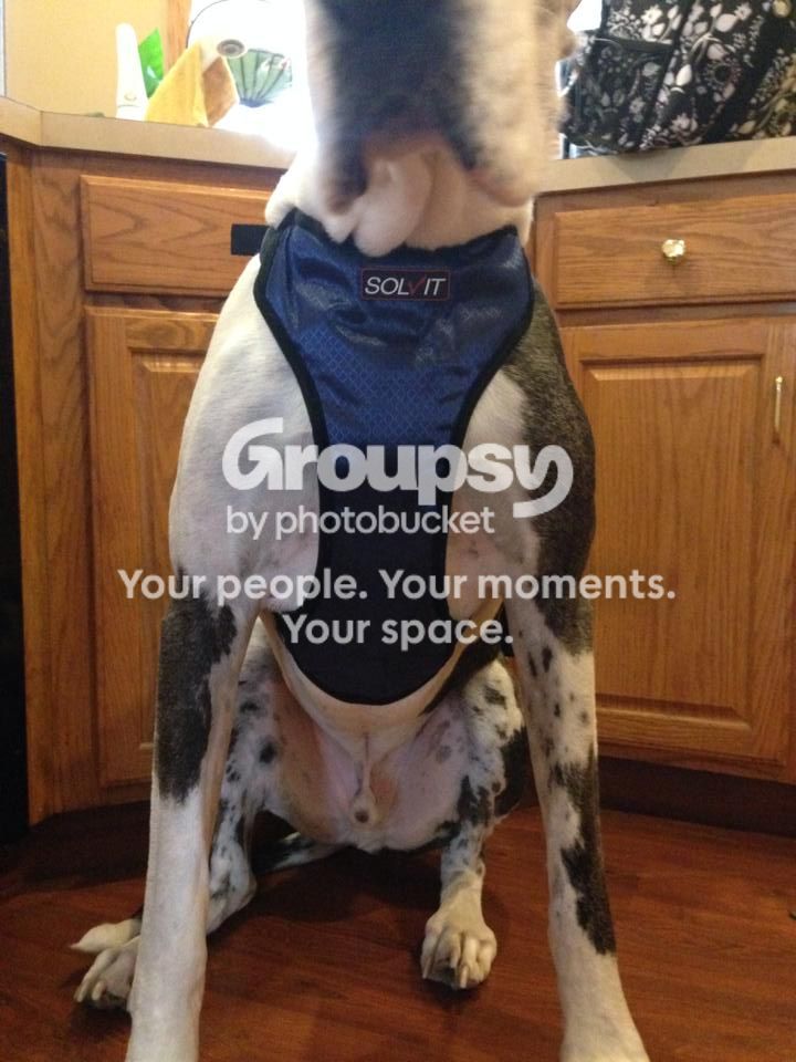

First off, the harnesses are really nice, quality webbing, heavy duty hardware. My dogs don't seem to the mind them at all and they can double as a walking harness. Here's a couple pics of the harnesses.

But here's what I didn't like: The instructions say to clip the harness tether directly to the seat belt. The problem is that if you don't have your foot on the brake the dog can pull the seat belt out as far as they want to and generally wander all about the car. And if you got in an accident while they had it pulled out then it wouldn't really keep them from flying around. You could clip the tether to one of the car seat anchor points, but the tether is only about 10-12inches long and the anchor points are either behind the seat back or in the seat crease by the seat belt clip which means that the dog wouldn't be able to move at all when clipped in because it's too short.
