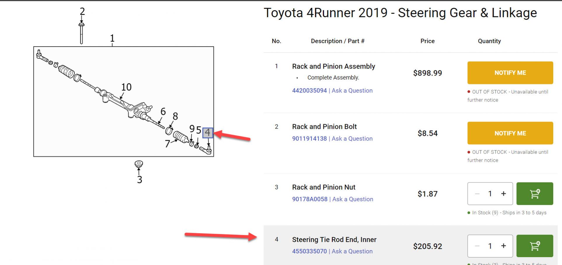

Steering System
5th gen steering racks having catastrophic failures on a trail seems to be fairly rare, but I've heard several stories recently of steering rod ends (either inner, near the wheel), or outer (near the rack) failing, and also the rack itself starting to leak.
OEM Part numbers for the 5th gen 4runner, per CARID
Steering rack: 4420035094
Inner tie rod (near wheel) (require 2 per rack): 4550335070
Outer tie rod (near rack) (require 2 per rack) : 4504669245
OEM part numbers for FJ Cruiser, per CARID
Steering rack: 4420035103
Inner tie rod(near wheel) (require 2 per rack): 4550335070
Outer tie rod (near rack) (require 2 per rack): 4504669245
(tie rod part #'s are the same as a 5th gen 4runner, good to know)

You have the inner and outer tie rods backwards. The Inner attaches to the steering rack or (near rack). The Outer attaches to the Inner, and is closest to the wheel, or (near wheel).
I'm aware of this, thanks. This is exactly how the CARiD lists it (incorrectly) so i thought describing it's physical location, and also including CARiD's label would be helpful (for folks like you who know the difference).
