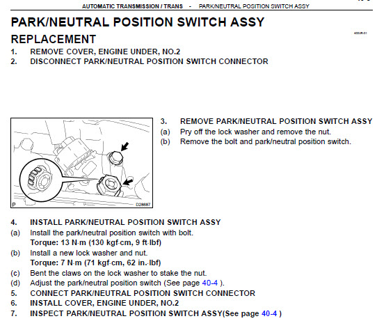

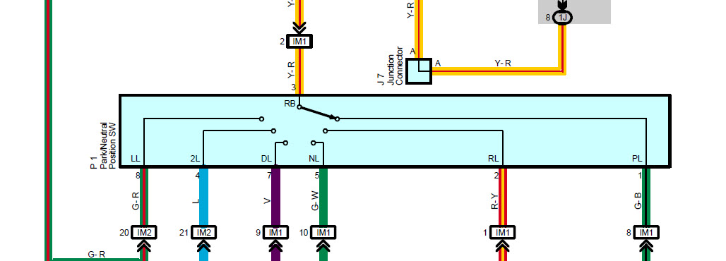

OK. I did a little snooping in the electrical schematic and learned that there is a something that Toyota calls the "Park Neutral Position Switch."
I can't seem to verify the location though. I don't recall seeing it in the shifter assembly when I took that apart a while back. It appears to be mounted to the outside of the transmission. These are the only mentions of it I can find in the service manual.
Anyone here recall seeing something that looks like this? It seems that "Cover, Engine Under, #2" is my location, but I can't find reference to that in the manual.

Those are usually bolted to the outside of the transmission. The picture in your diagram looks like it is. Should just be a few screws a nut and an electrical connection

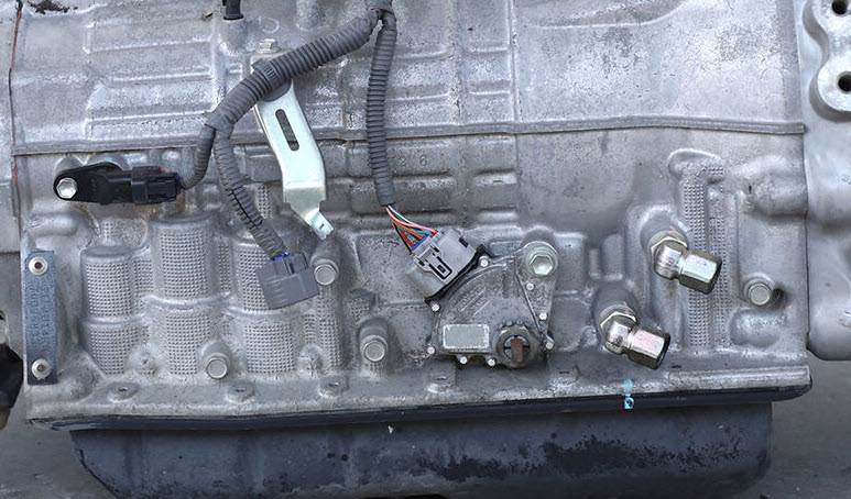

OK, so here's a followup: I found it
Passenger side of the transmission, just above the pan. SHOULD be easy-peasy to replace.
I'm not thrilled that it's a $200+ part from online parts places, and suspicious of the $29 ones from ebay (even though the photos look like an authentic part, who knows....)
