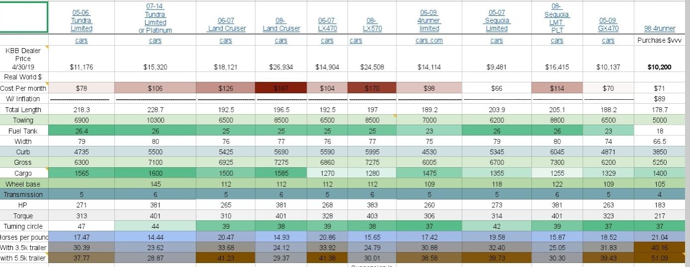

I have had my 1998 3rd gen 4runner for about 12 years now. With the exception of a failed ignition module and a leaky ac system I have put 110k trouble free miles on it. It currently has about 215k on the clock and runs great. A couple years ago it needed some new shocks in the back and I went ahead and added some heavier duty springs in anticipation of pulling a small camper. My primary complaints are range and power followed by cabin noise. Reliability and longevity are why I picked the 4runner a decade ago and that has not changed. My wife has a work car and I work from home so the next vehicle is going to spend most of it's time in the garage for the next few years. It also means it will probably be around for at least a decade or two. One final requirement is the ability to get our bikes in the back so they can be locked up. I need to be able tow tow up to 5500#. What do you guys think? Is the 4runner the right tow vehicle?

Ehhhhh maybe to answer your question. This was my girlfriend's 4th gen a few years back:
I think our travel trailer weighed in around 5500lbs empty if I remember right. The 4runner is a 2003 (so doesn't have VVTI/more power like 05+) and we bought it was 215k on the clock, and it towed the trailer surprisingly well. We towed that trailer from the mountains in Colorado to where I went to school in Northern Utah, and then back to Colorado, and then from Colorado to Southern Utah where she now goes to school--so this was all towing across the Rockies and 4000-9000ft. Was it fast? No. It could hold about 70 on the interstate if it was flat, but much of a hill and it started working for it. If you want a 4runner, and you plan to tow around on little highways, I think you'd be fine if you're not worried about going up passes at 60mph. The 4.7 is a workhorse, and you can get them relatively cheap (like I said ours had 215k, and was all stock with no rust for $4700) and they run forever. The only issue we've had with the truck was the exhaust manifold leaking which is a common (non-critical) issue, and we're just now fixing that this week as the truck is approaching 270k and runs great as ever.
The original mods I did on the truck were specifically for towing, I upgraded to the sport calipers and EBC drilled and slotted rotors plus all Fox suspension with compression adjusters in the back and 2" lift Icon rear springs, that topped with dual braking axles on the trailer and an equalizer hitch made the 4runner sit about level and feel fine.
Now with all that said, I wouldn't push it much over that if you didn't have to.
This trailer is single axle (shittily) braked, and the trailer alone is 2500lbs and no equalizer. It towed my FJ40 plus a dirt bike and my 600cc sport bike from Utah to Colorado, but it wasn't happy (relatively speaking, it still towed it up really steep mountains surprisingly well). And we've tried towing my old racetruck (that the Tundra has in the top photo) and the 4Runner couldn't handle that at all--but that load was also 8000+lbs, and why we got the Tundra.
Conclusion, depends how fast you want to go and if that's the most you plan to haul, I personally wouldn't hesitate. Just have realistic expectations, it is a 5000lb truck stock and 15+ years old for the older ones.

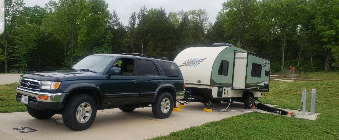

Is the RPod in your picture what you’ll be towing?
If so, you’d be totally fine with the V6 towing that, although I’d personally go with the 05+ To have the 5spd transmission.
The V6 is officially rated at 5,000lbs, but I believe that is with the lighter duty hitch and no aux trans cooler.
I put the class 3 hitch on my 05 V6, an aux trans cooler, brake controller, scangauge to monitor the trans temp, and a weight distribution hitch on my camper and it tows really well, considering it’s not exactly a classic “towing rig”.
The camper we pull is a 18’, 2,500lb dry weight hybrid camper, probably between 3,000-3,500lb with all our gear when we are going somewhere.

I have a 2006 V-8 Sport and an Rpod which looks nearly identical to yours. The Rpod weighs in at 3100 dry, so I'm not sure where the 5500# is coming from. Even with all of the tanks full and a reasonable amount of gear you shouldn't be much over 4000#.
The 4Runner has plenty of power to accelerate the combo, and getting to 70-75 mph on the freeway is not difficult. I have OME aftermarket springs in the back, which stiffen the suspension quite a bit and work well for towing. I use a stabilizer (but not WD) hitch, and the trailer tracks perfectly at 75+ mph, even in Kansas crosswinds. I don't normally drive that fast (65mph usually), but I've done it just to see how it feels.
The big issue I have is "hunting" of the transmission. Due to wind resistance (not weight) of the Rpod, 5th gear is pretty much useless, and even a fairly slight grade or a mild headwind will have the transmission shifting from 4th down to 3rd pretty regularly. The hunting is worse with cruise control engaged - if I drive manually I can do a much better job of managing transmission shifts than the cruise control does. (As an aside, the cruise control software on the 4Runner has to be one of the poorest implementations of a control system I've ever seen.)
I've been strongly considering regearing to 4.3 gears from the stock 3.73 ratio. I think that would put the engine in a much better power band at highway speeds. (One thing I should add is that I have 32 inch tires on the 4runner (stock is 30.5), which effectively lowers the rear-end ratio to 3.55 vs. stock. So that doesn't help the hunting problem.)
I like the 4Runner for a lot of other reasons, but if I didn't already have the 4runner and I was starting now buying a vehicle as a tow vehicle for the Rpod, I'd look for a later model Sequoia with the 5.7 liter 385 HP engine. The extra 100 hp and ~100 ft-lbs of torque would be nice.
