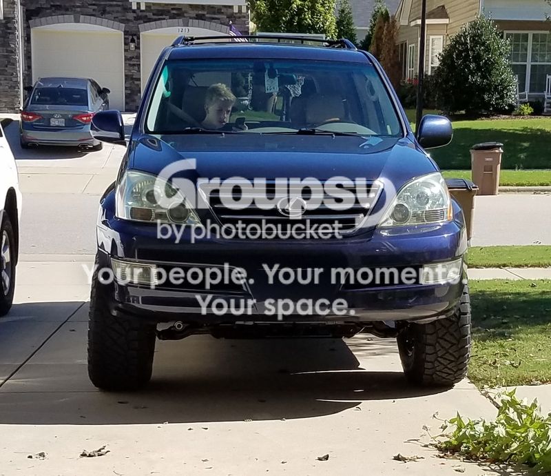

So I just got my GX back and I think I need to fire my allignment shop. When I first got my lift in 2" front and back. New OEM UCAs, LCAs, bushings , links, everything. Also 285/70/17 icon rebounds with 4.75" backspace and 0mm offset. The first time the aligned it they could only get to 1.9 camber and caster. I think negative on both but I cant remember bc they dont give you the readout sheet. So after that the tops of the front tires stuck out farther than the bottoms

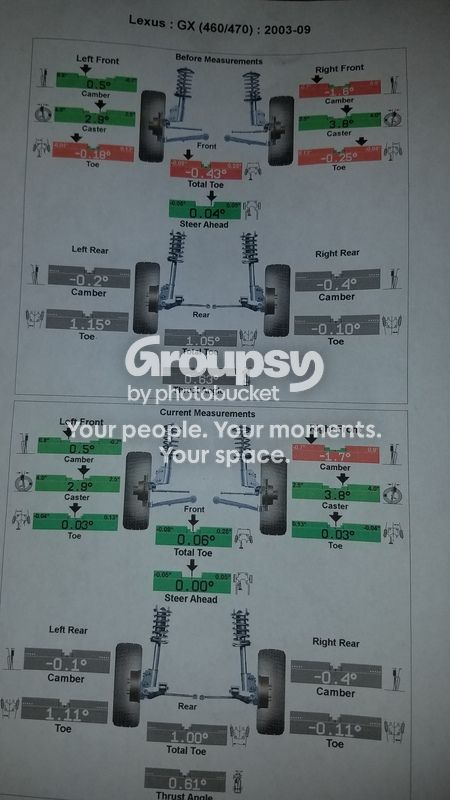

So negative caster I guess. Well I installed SPC UCAs to lay and set them for +2 caster and slid them all th way in. Pic of how extreme the positive caster was. So take a look at the report I had to ask for. They are showing that the only improvement they made was on toe???? They said that was the best they could do after having it for 4 hours. I even told ththeththem that the SPCs were adjustable and left them the instructions.

Here is the report they gave me.
Does this vehicle look like it came in with negative caster to you? And their report said they didnt touch it.
Sorry that was my before pic
I slid the SPCs all the way in so that they would have plenty to work with. The after looks way better. But now it runs again. This a great hobby. But really frustrating some times
Your caster is fine. You have negative camber. Not sure what would cause that much negative camber though. I'm not familiar with spc uppers, but if you slid them all the way in towards the engine bay then that's causing your camber issues. Not sure why the shop couldn't adjust them where they need to be.
Every vehicle is a little different but I like setting the SPC ball joint about in the middle to slightly towards the outside for the simple reason of providing a little more clearance between the tire and UCA. From there, I see where the angles end up by just adjusting the LCA cams then adjust the ball joint if needed.

Good luck! If they said that's the best they could do I'd suspect a frozen alignment cam along with the tech not understanding manipulate the SPC adjuster. Competent tech should be able to help you out. I use Firestone for my "maintenance" alignments and take it to a specialty shop for real alignments
Incompetent tech, just take it back and teach them. Don't worry, I can't find one around here either. Local places wouldn't touch the SPC's but they do warranty their "alignment" for 30 days. So I have them tweak it, take it it home and adjust the SPC's more myself, then come back a half hour later and tell them to do it again. After they caught on that I wasn't going home til I had 0 camber, 4 caster, and 0 toe, they actually started moving the alignment cams and not just toe and go.
