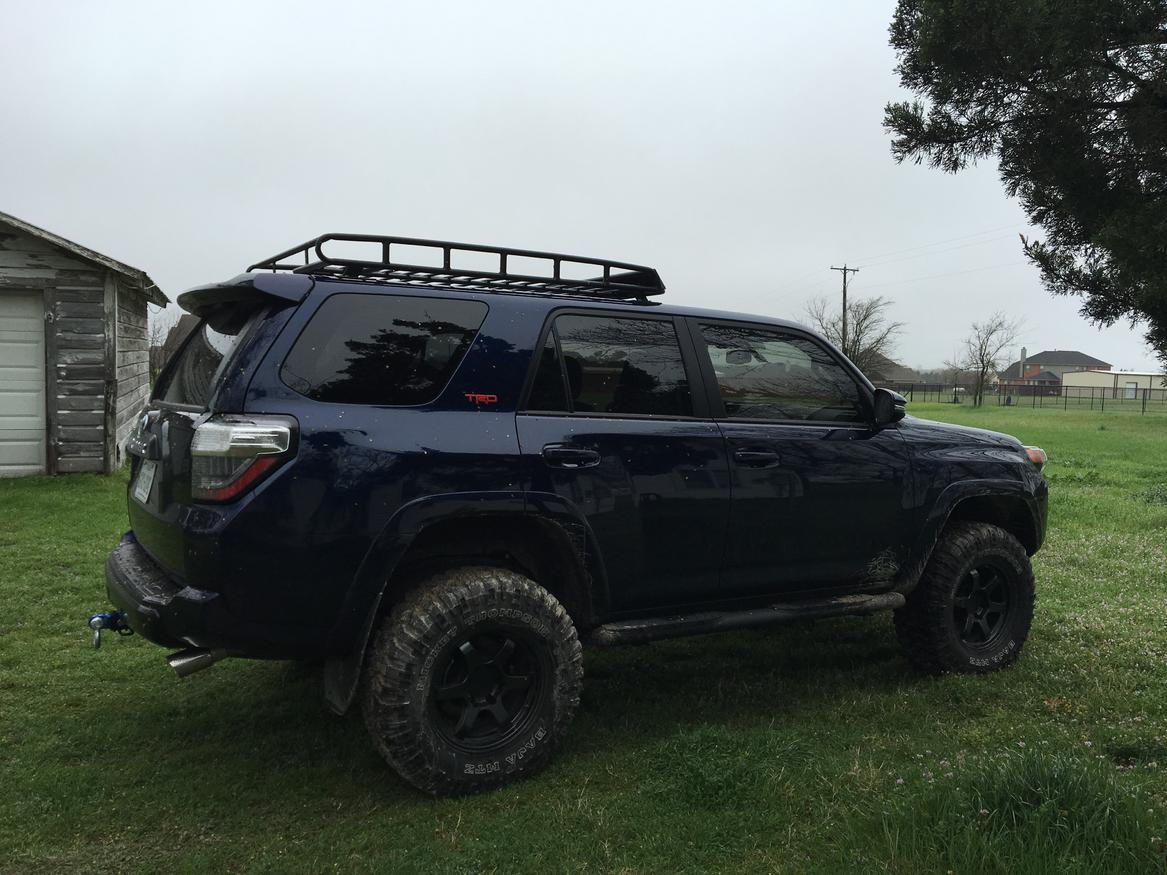

Just got a Yakima Load Warrior but was not a fan of how the rack's bolts extend past the thumb knob adjustment nuts and poke out above the flat bottom. So I cut about 1.5 inches off of each bolt, ran a 1/4-20 die over the cut threads to clean them up, and used lock nuts instead. This way I can use a wrench to tighten them down instead of my hands.
With shorter bolts and locknuts

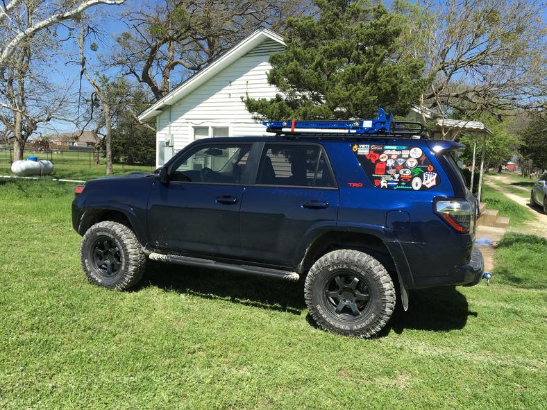

I had a Yakima on my 4th gen and hated how high it sat so I flipped the mounts around opposite of how yours is. Only pic I can find is this one

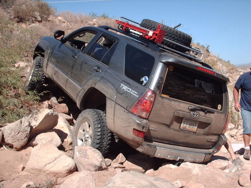

And here it is with the high lift mount. The axe and shovel are on the other side.
