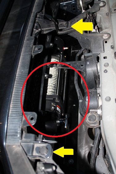

If this is the bumper for the 5th gen, the winch should mount directly to the bumper. You should see the (4) mounting bolt holes on the front face of the bumper, since it mounts 'foot forward', meaning the feet are facing outward rather than down toward the ground. I'm unsure what aluminum frame you mean, but if you're referring to the aluminum factory bumper bar, that part comes off before you mount the new bumper.
I installed my bumper by myself so I waited to drop the winch in after it was mounted, but this is where it mounts, with the feet facing forward as apollo said. In my sig pic you see the 2 mounting bolts on top and the fair lead mounted with the 2 lower bolts. I dont think there is any aluminum on my bumper but there are 2 structural ribs that look like a shelves, but my winch did not mount to those.
