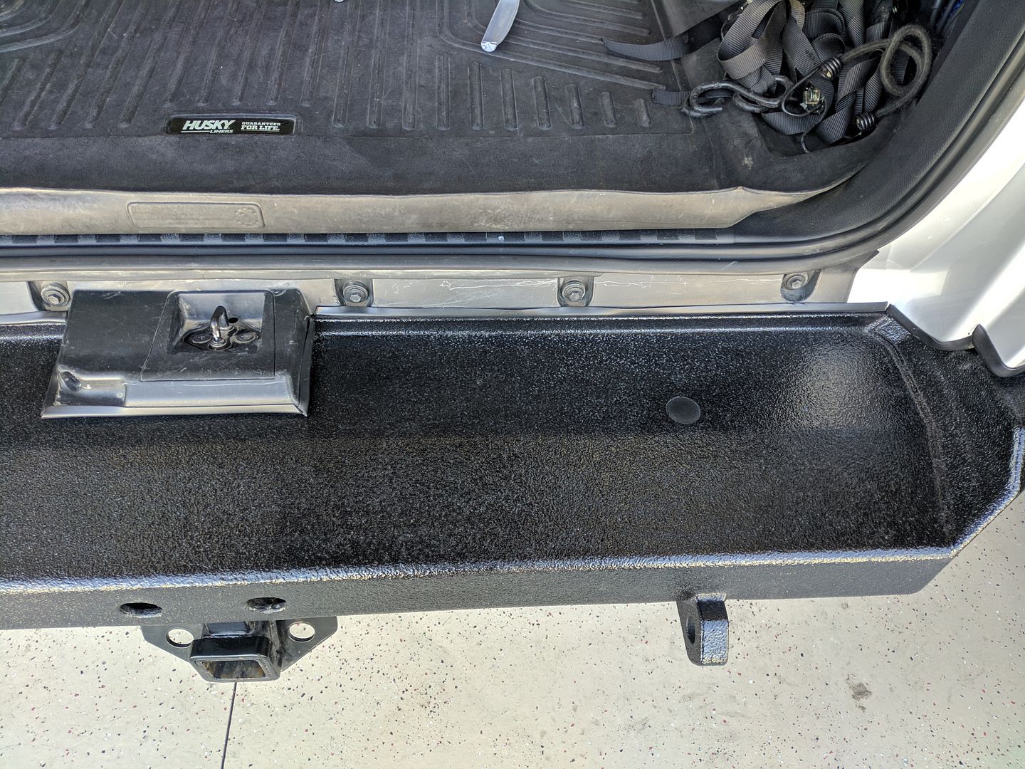

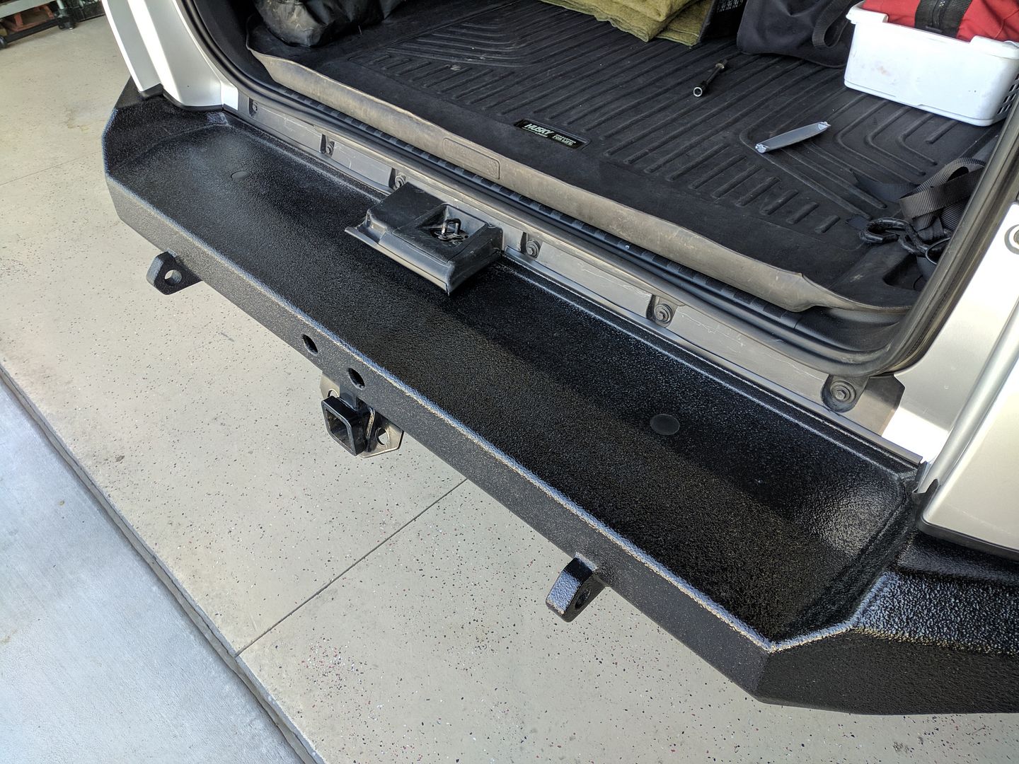

Been excited about this install for some time and very happy with the final results. I ordered it in bare metal and dropped it off at Linex for coating with the Platinum liner,, good stuff, looks bullet proof.
The install went fairly well, a couple of shims didn't make the shipment so I had to fab 'em up, and the Linex thickness made for a bit of persuasion when installing the hitch. I still want to clean up the plastic molding trim pieces a bit.
The build of the bumper is excellent, super quality work and I really like the tight lines of the Shrockworks product. Very solid build.

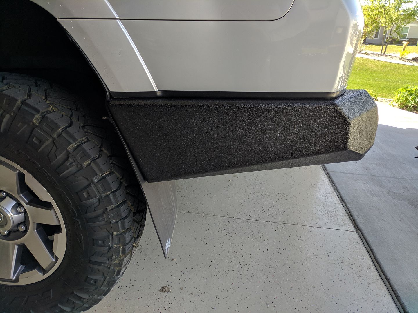

What kind of mudflaps do you have? I still haven't taken care of that...

Is there any functional difference regarding the hitch vs the stock hitch? The stock hitch is just a four-bolt add-on anyway, right?

They are RockBlokz standard size flaps. Had to drill a couple of holes in the bumper to install using self tapping screws and also fab a small bracket for the inside mount point. Also used a heat gun to shape them around the bumper.

More ground clearance and it seems a bit stouter. A bit more effort required to get the pin in.

That's really clean. Congratulations! Nice job on the mud flaps, too.
Can you take some photos from a lower angle? Curious how the underside looks.
Looks good! Great job on the bumper cut and mud flaps
Forgot to mention. Found the best/easiest/most accurate way to cut the plastic was to use a jig saw with a metal cutting blade and set it to slow speed. Super easy to control for accurate cut. And for the tight corners, warmed up the plastic with a heat gun and used a razor knife to slice and dice, worked like a champ.

Bumper looks great!!! I've been trying to hold off on a rear bumper but most likely going Shrockworks if (when) I do. It also appears like they updated the bumper a bit too. I remember the earlier versions had a large gap between the plastic trim around the cargo area/striker latch and the bumper itself. Now it looks like they made it a lot tighter to the body and it looks much better.
Looks great! I appreciate the top-down pics with the door open as I've heard about the big gap into the cargo area too.
