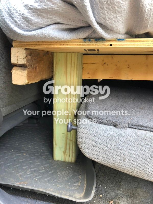

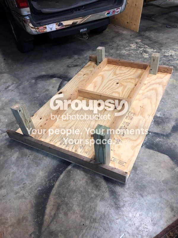

My wife and I are going camping this weekend. No kids!!! It's going to rain. No doubt. I don't care for pitching tents in the rain so I decided to build a sleep platform. I've been wanting to do it for a long time just never "had a reason". I spent close to $60 on materials.
23/32 sheet of plywood cut down to 4'x6' (could've gone thinner on this).
Rear 4x4 legs are 10".
Front 4x4 legs are 16".
I took the rear seat bottoms out so the front legs sit on the floor. It's all one piece. No hinges or compartments...yet. Let's call this the beta version for now.

From the pics it looks like you used pressure-treated 4x4 posts for the legs of your platform. The wood preservative used now is a copper-based chemical which is less toxic than the arsenic-based one of years ago, and may not really be a problem. But you may want to coat them with paint or polyurethane. I’m kind of OCD that way.
I did use pt 4x4s. That’s a good point. We will have a fan running because wife got a last minute spot at a campground with electricity and water. Whoop! I thought about using pipe for the legs. I don’t think it would feel as solid though. Probably should just paint the legs.

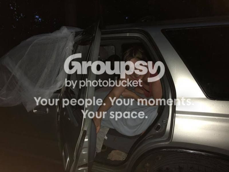

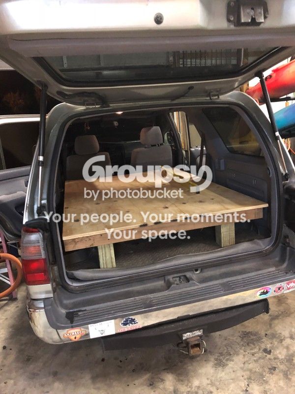

Great idea! Would you mind posting a picture looking through one of the back doors? (To show how it looks with the seat bottoms removed)

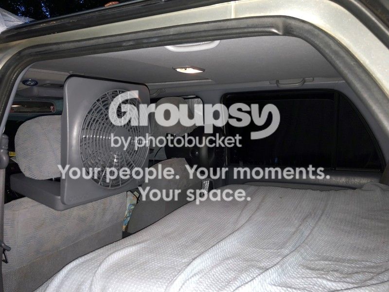

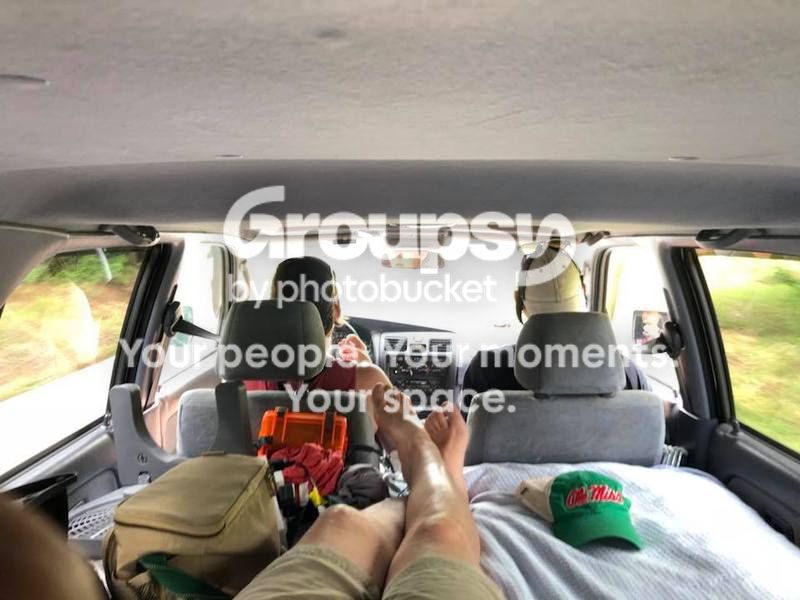

The sleep platform worked great (I do want to make some improvements though). Used 2 foam mattress toppers and a comforter for cushion. Slept fine. Getting in and out was easier than I expected. It was nice to have power and water at the campsite.
My buddy lost his van key so we had to head into town so he could call a locksmith. I volunteered to ride in the bed. So comfy!
I'll try to get a pic tonight before I take out the platform.
Does your design allow access to the PS rear storage compartment?
No access to the storage compartment with this design. Under the platform I was able to store our bag chairs, paddles, axes, fire tongs, various small bags (toiletries, cooking utensils, etc.). There's also a decent amount of storage under the platform via the rear side doors.
[MENTION=130490]NCRidgeRunner[/MENTION], here's the pic you requested. I may have "overbuilt" it a bit. No need for 4x4s although there was no movement when crawling on it. I was leery of putting the legs on the back of the seats for fear of damaging them. It's very stable.
