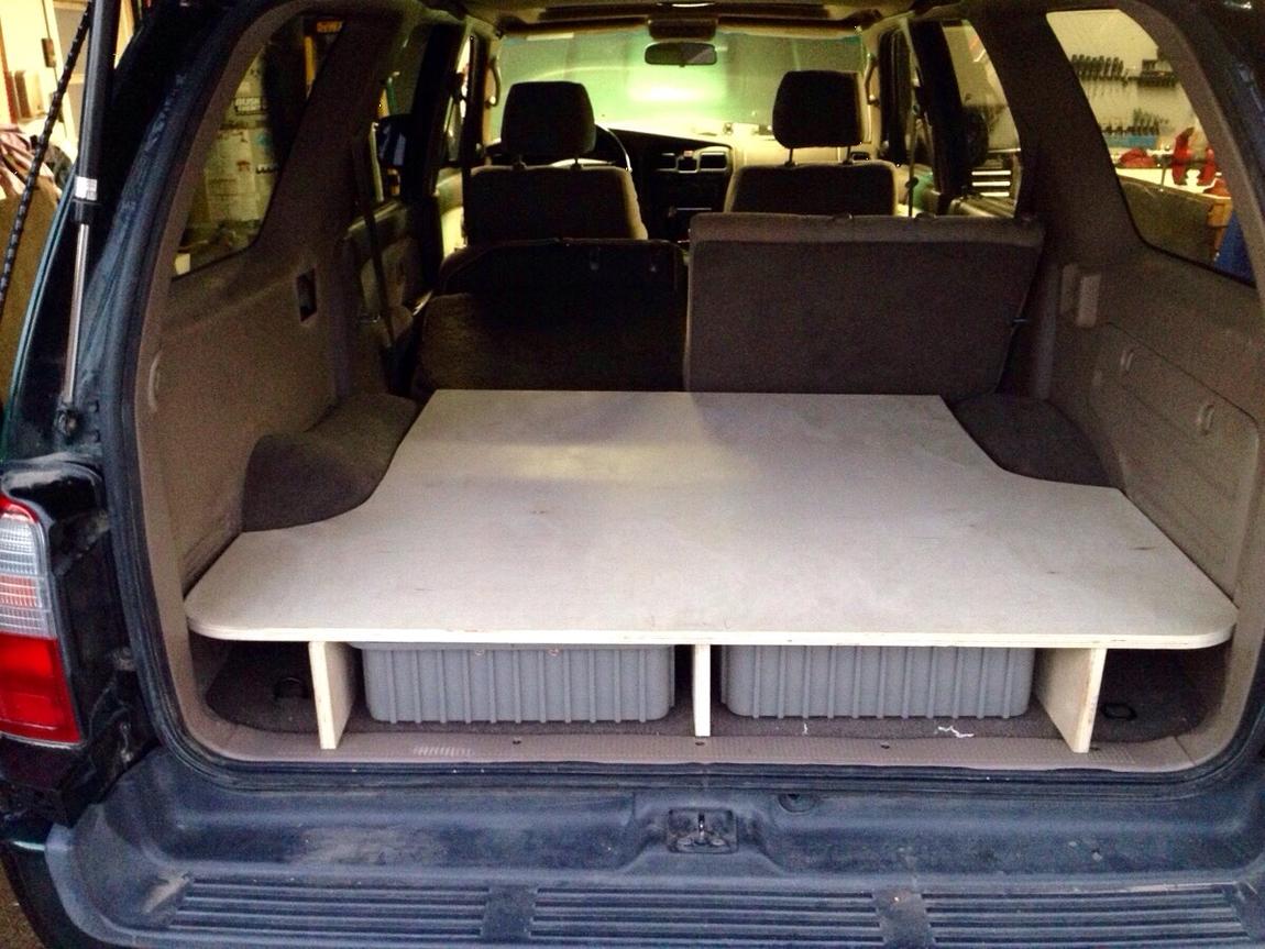

This is how close I got with just cardboard and a measuring tape. As you can see it's not perfect, but once you add 1/2" padding and carpet it fills in the little gaps nicely. I can't tell you how much I love the extra easy-access cargo totes; every time I need a tool, rope, winch gear, or just my light jacket I know exactly where it's at.

If you want it tight I'd personally take the wheel well carpet covers off, decide how high you want to be and build the rest of the platform, once you do that, make your piece of cardboard that hugs the curve on each wheel well, then trace it on your wood, and cut it with a jigsaw leaving a little etra meat there for you to alter slowly to make it tight. Keep in mind if your carpet is plush it can hide small imperfections in your cuts very well.
