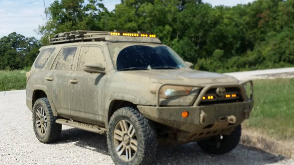

I have Shrockworks on my Unlimited. I have been very happy. I beat the crap out of them in Moab and Colorado and they have held up like a champ.

The OPOR and Rocky Road sliders will fight right onto the Limited without any modifications. Works with XREAS and works with the rocker trim stock.
The Shrockworks will fit onto a Limited with stock XREAS suspension but you will have to either remove the rocker panel, trim the rockers, or buy a replacement rocker (OE Trails or Shrockworks trim).
Sounds like all other sliders will need XREAS to be completely removed along with addressing the rocker in most cases.
