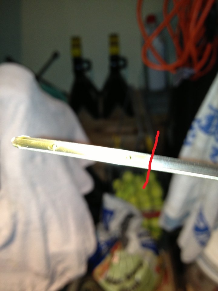

Where is it on the dipstick?

From the add line to the full line it's about one quart.
Thanks for the responses guys. See the picture I took. The red line shows where my oil level is after a refilling with 6 quarts and changing my oil filter. This is after driving around for a few days.
1. Is this amount of overfill ok?
2. How come I'm slightly above the fill line from others who say after 6 quarts they are right at the fill line?
