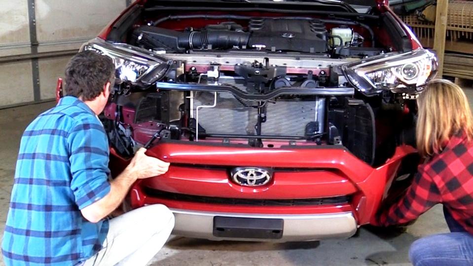

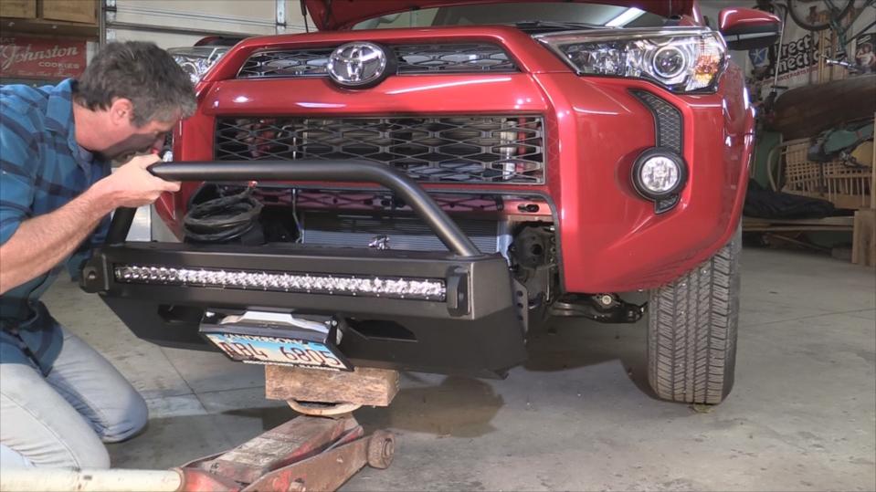

The install went off without a hitch, thanks in part to getting all the necessary hardware and having the mounting positions line up perfectly. We see, and understand peoples reluctance to install one themselves, mostly due to cutting the opening in the stock bumper. Let me tell ya, it's as simple as can be and pretty much "dummy" proof, as we have proven. If you have a Trail/Offroad or Pro you simply use the "bumper cap" as a template. If an SR5 the bumper comes with a paper template which you can use to mark where the cut needs to be made. We were also amazed at how easy the front clip came off the 4R. just a handful of bolts and fasteners, a few tugs to release the clips and off it popped, easy-peasy.

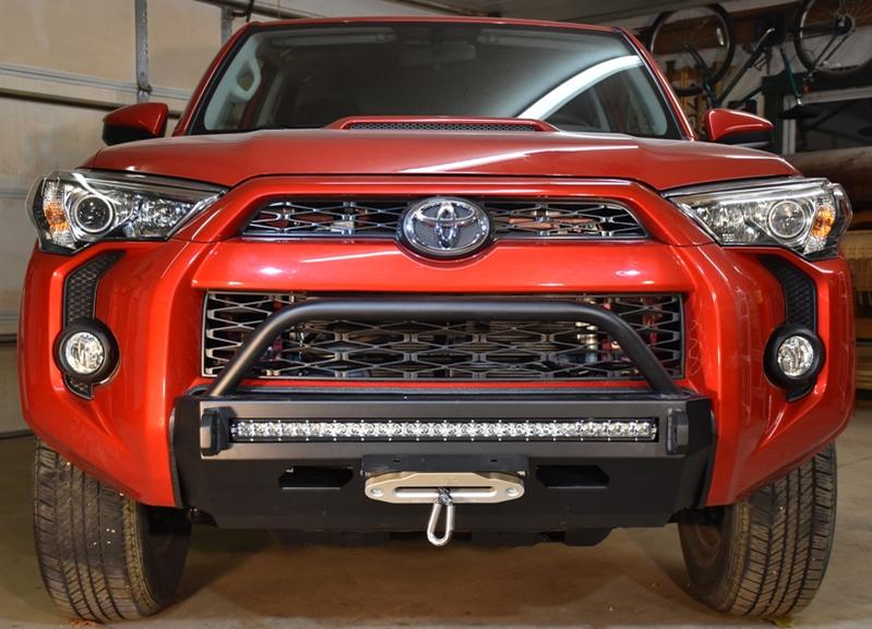

Our bumper has been installed for six months, three of which spent on salted winter roads, the powder coating and fasteners are holding up fantastically! Aesthetically we couldn't be happier. The hoop is just the right height, so as to not obscure the stock styling. The flush fit of the light bar is an outstanding detail. Access to the winch controls is easy for such a bumper, through the openings cut in below. The bumper doesn't take away from the "tough looking" factory styling, like full width steel bumpers often do. This bumper actually adds to it.

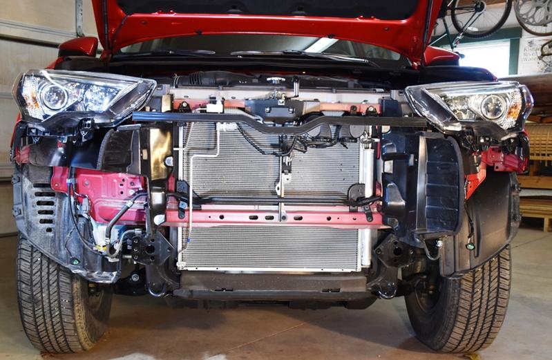

Nice video. I will reference this when I install mine. Did you notice any issues with removing those plastic air flow redirectors next to the radiator? I read where one person had decline in AC function and the driver side fender came loose from air being forced into the space between the wheel well and bumper fascia without that piece of plastic in place; highway speeds. I haven’t heard it from anywhere else so I was wondering what your experience has been.
Sent from my iPad using Tapatalk Pro
We haven't experienced any of that with ours. We did keep our deflectors with the intent to trim them accordingly and reinstall them next time we have the bumper off though.

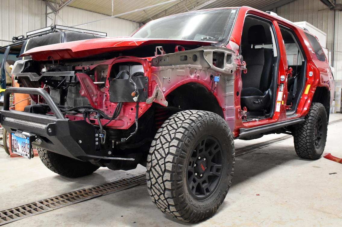

I don't see why that wouldn't work. Here's a pic of ours in the body shop after Merri hit the cow. You should be able to drop the winch right in.
