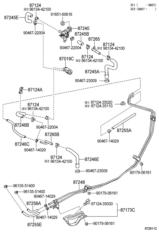

I just changed out mine there a pain in the ass you have to take off the top hoses for sure. I suggest just changing all of them since they all have to come off
here a diagram for you

Thanks for the info Rob!
Mine is also already bypassed. I think the heater hoses themselves on mine may be fine (the two I suspect are leaking) but the clamps may not be tight enough anymore to hold back coolant under extreme temps.
Now that I got the part numbers, I'll replace the hoses and clamps.
