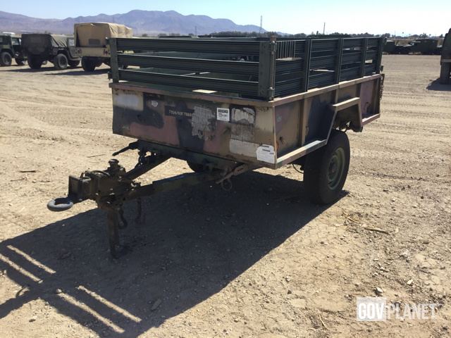

Surplus 1968 US ARMY Tank Automotive Command M101 Cargo Trailer in Barstow, California, United States (GovPlanet Item #906737)

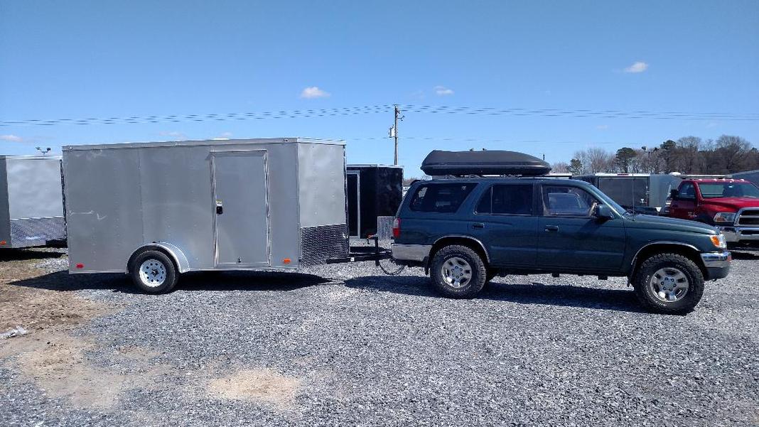

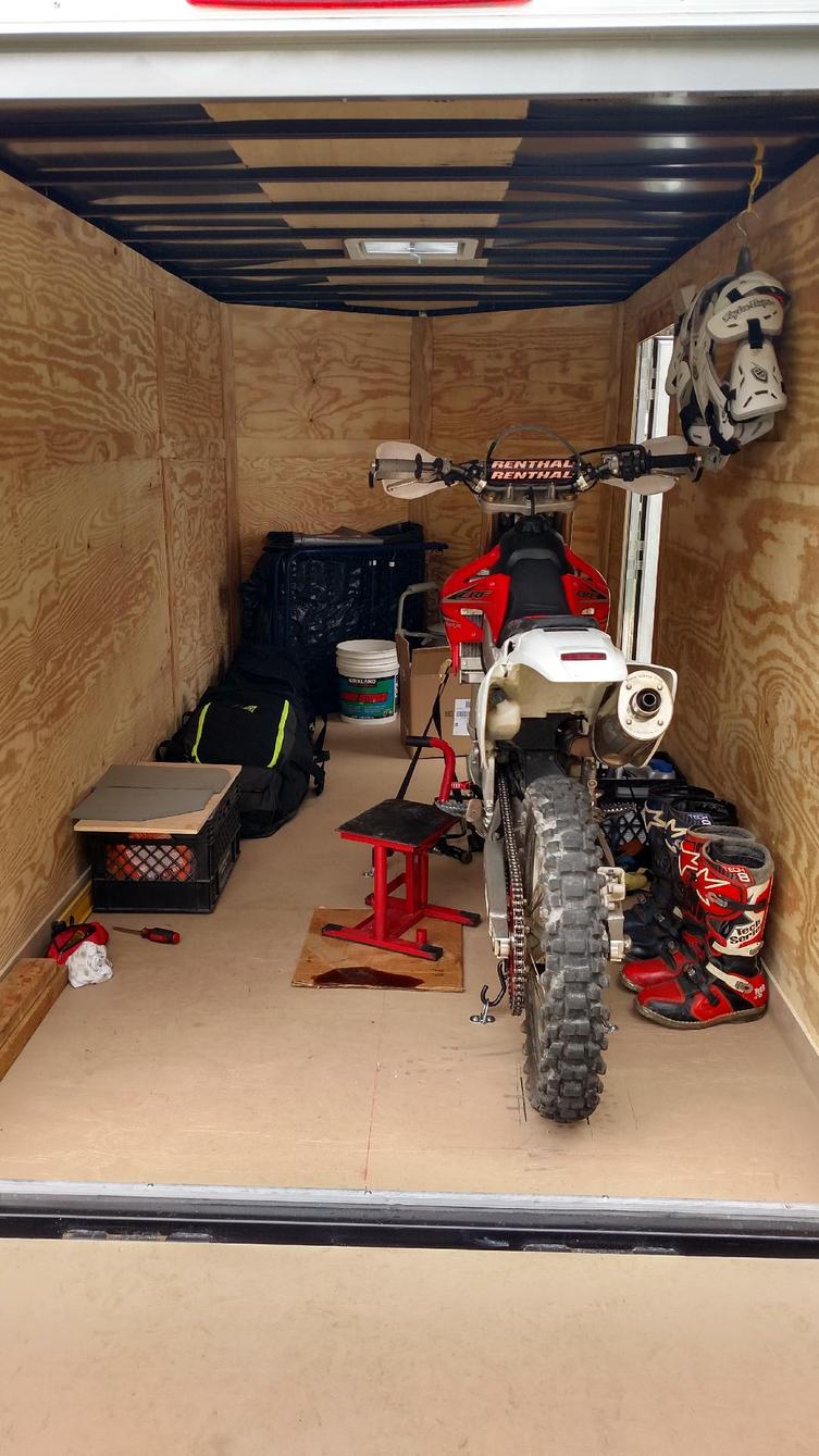

I was using a hitch rack and car camping in my 4Runner when I would go trail riding. It got kind of cramped with my gear, so I bought a new 6x12 enclosed v-nose trailer for $2,900. I sleep on a full sized cot and have a portable toilet. I unload the bike and lock it up and have plenty of room inside!

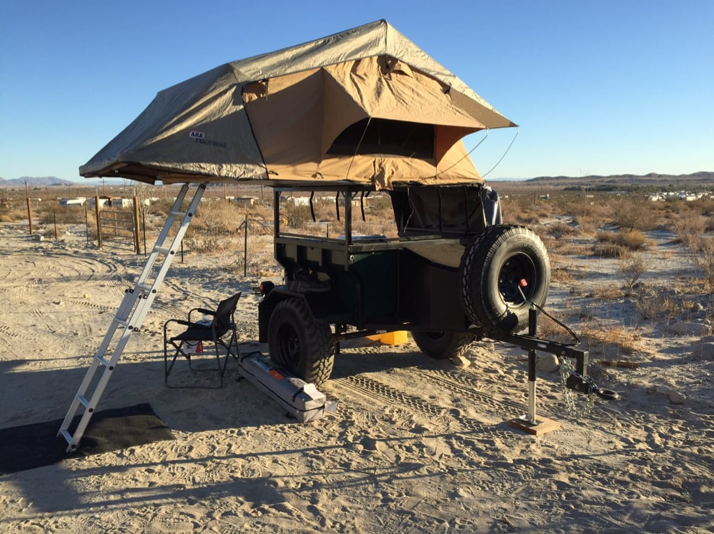

If I were to go the RTT route, the one i currently like the most:
https://www.ikamper.com/
Seems very well-conceived...

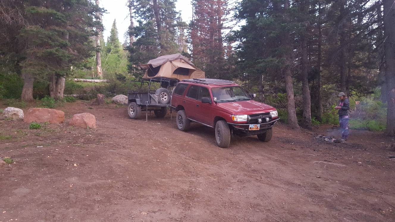

Perhaps build your own using an old pickup bed and axel as a base. I think one of the most important things to consider is that you want the trailer to be as short as possible in California. The campsites here are usually long enough for two cars which means if you have a short trailer you can park in a standard campsite. RV sites cost a lot more. My parents have a 20 ft RV they trailer and unfortunately they can only stay at dedicated RV campsites which cost as much as $50-60 a night and in the national parks most sites are for normal camping not large RVs.

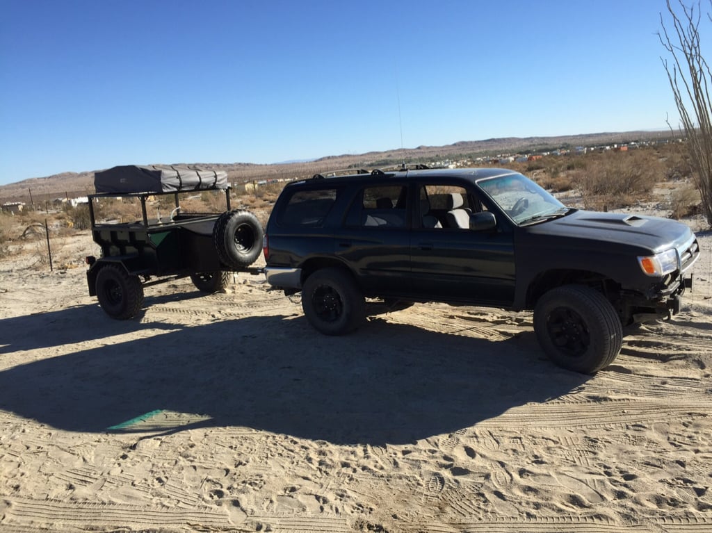

I tow a small trailer I built myself. I originally thought about buying a small trailer and modifying it to fit my likes. But I just ended up building the whole thing. Mine is 48"x65" and 20"deep. I also have a tray on the front for 2 Spectre gas cans a spare tire and a tool box. The tailgate is outfitted with a kitchen, and the bed has enough space for my RTIC 65 and 2 large action packers for gear. If I were doing it again I might go a full 72" long on the bed size tho, since my kitchen takes up quite a bit of real estate back there. I haven't weighed it, but I would guess <800 lbs, loaded and ready to camp, I can pick the tongue up and move the trailer alone.
I love the utility of it. You get the convenience of a roof top tent but its nice to be able to park it and set up camp and still be able to use the truck. It's also light enough to take most places, and it handles trails very well. And I don't have to drive my truck around with the tent installed all of the time. I think its a great solution.
There are some super cool trailer manufacturers out there. CVT has one. Manley ORV, Smittybilt, a little outfit called Trail Tested Manufacturing, Adventure Trailers, Compact Camping Concepts, to name a few.

I purchased a 3.5 x 5 utility trailer from Lowes as a starting point. I plan on building a rack for a RTT. I want to keep it light as possible since our trucks aint exactly rocket ships.
That military trailer looks super heavy

EDIT/ADD: Yup, the M101 military trailer, empty 1,340 lbs...

First modification I did was to flip the axle. Gives about a 4 inch lift.
Next is to build a waterproof box out of marine grade plywood to keep gear out of the elements. Paint exposed wood with Herculiner.
Next I will mount a rack to the top of the box. RTT follows.
Reinfornce the trailer tongue by having my buddy weld in a A-frame
Cut out the stock fenders and slap on some old 265/75 r16 tires. Just need to find some hub adapters
Its pretty much a general idea of what I want to build. I got some insipration from another forum called https://tventuring.com/

You don't want to use the older m101 trailers.
Towed them in the Army. Had one for several years. They are heavy as hell. The floor is 1/4" steel.
If you can find a 1/4 ton jeep trailer (getting pricey) that would work better.
