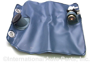

I purchased it and after some more thought have decided to scrap it. I am looking at reservoir bags much like the older Bronco Bags. I believe I can splice the wires to the pump and install with sheet metal screws and washers to the passenger fender wall just in front of the air box. I think this will hold up better pre running through the desert. I will lose the squirters to the rear window but no biggie.
That looks interesting. Never seen a bag like that.

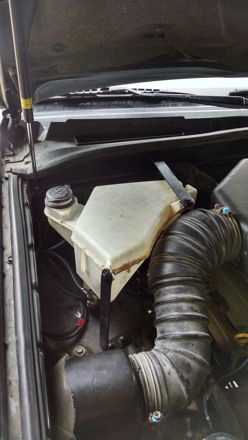

The factory reservoir has a round nub on the bottom. I strategically drilled a hole in my fender well and used a rubber gommet and a piece of rubber hose to protect the reservoir. Fabed up the simple brackets to hold the reservoir in the right spot so the hood cylinder didnt hit it. Yes you can change the breather filter easily. It does look tight but its not. Extended my wiring with a $5 weatherproof 4wire plug from the parts store since my factory pump harness was damaged in the wreck. I took a hack saw and cut the factory fill tube just below the lid and pushed it in the rubber grommet on top of the reservoir. That was luck.
I didnt take enough pics to do an entire write up but its easy to recreate.
Heres what I done.
Heres what I done.
