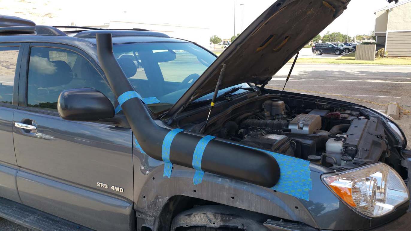

So I just ordered a snorkel kit for a tlc80. Heard rumors that it will fit, with modification of course, and will be documenting my experience. I've seen people use tacoma, hilux 167, and a few other kits. This one was only $69 bucks so I won't be to bad off if I mess it up.

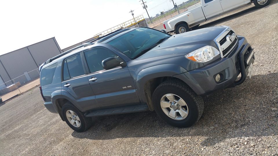

4runner is an 06 4.7 sr5. 3 inch strut spacers up front and 2 inch in the rear, bull bar, 23 inch led bar, tail light guards. Just got it. It's my first yota been a jeep cherokee guy til now. Only thing that sucks is the head room. Not meant for someone over 6ft.

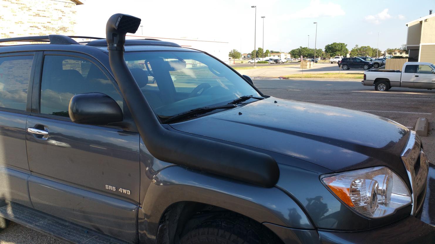

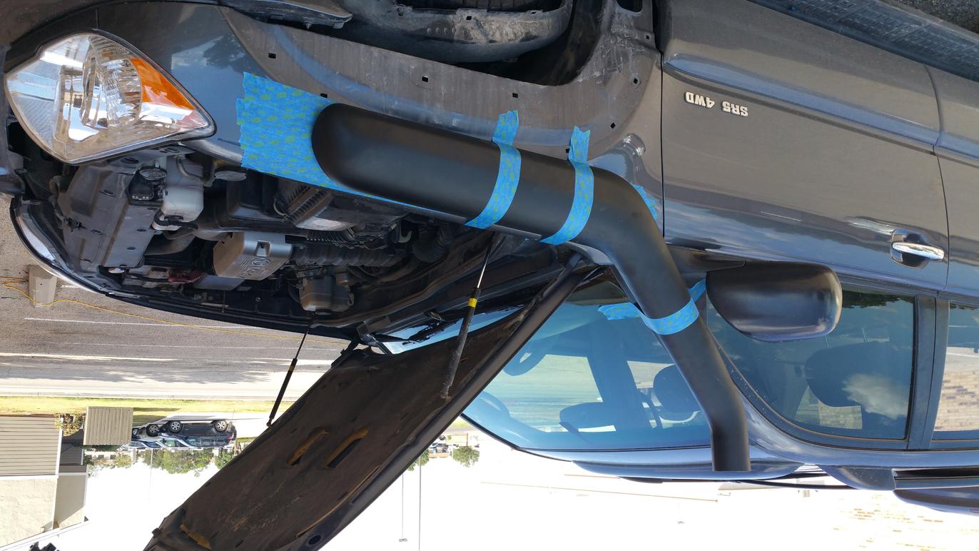

So it's on now. Looks great. Fitment is almost perfect. Used a 3.5 inch plug jack to drill l the hole for the intake. Man just getting the fender flare off and the liner was a pain in the ass. Fml.

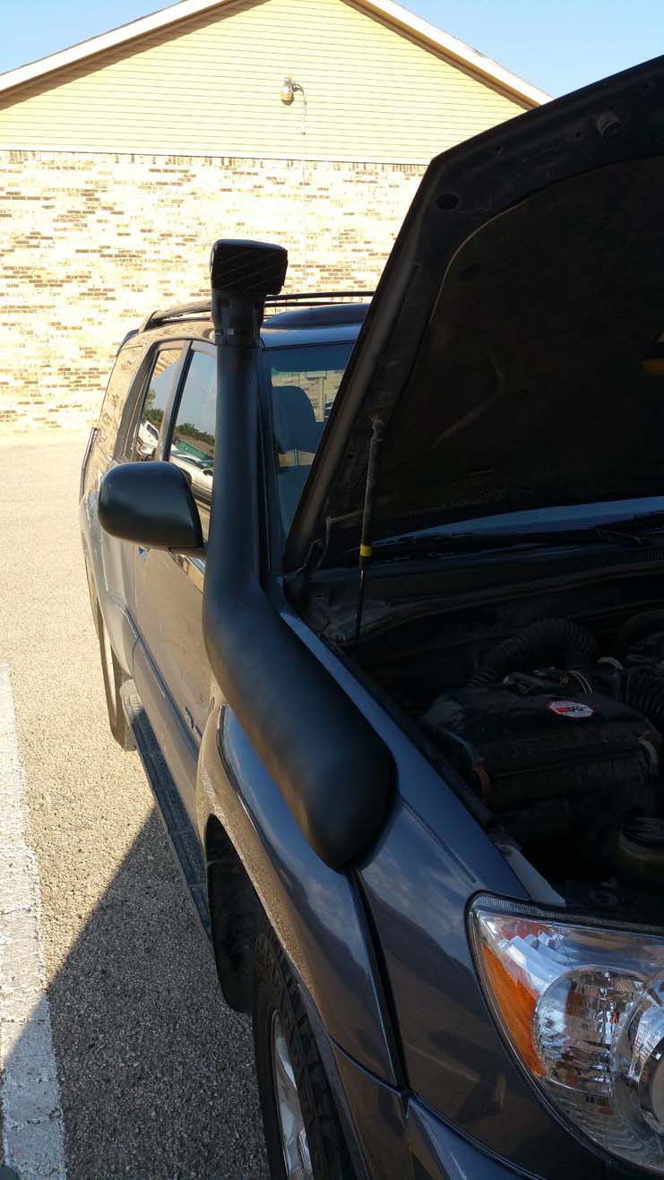

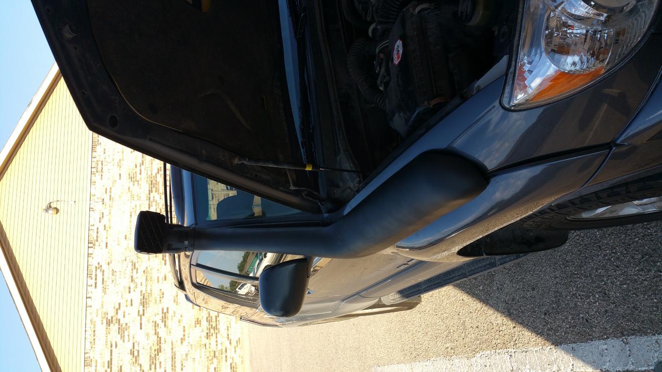

I rotated the two Pics. Good Job! Is this for high water crossings? If so, do you fear any damages to you hot engine and parts from making contact with the water? Thanks!
While a snorkel may aid in water crossings, many folks use them in dusty conditions to allow cleaner air to be sucked in. It's not uncommon for folks to flip the head 180 degrees so it is facing rearward.
True. I have also seen snorkels rotated 90 degrees inward to keep mud from getting thrown in by the tires.
