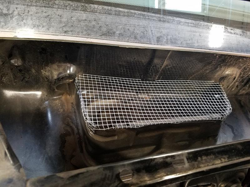

248263d1492305479-zombie-truck-2-0-mpav-build-20170415_164121-jpg
That's a picture of my 4th gen's inlet after I installed a rodent screen on it as a precaution (something I think is stupid of Toyota not to do and I have mentioned it to the FTS and engineers multiple times when they visit and ask why I have a car torn apart or why I am installing a grate on the opening...)
It's not much different on the 5th gens, same general shape and location. That being said, usually the cowl has a baffle built into it to prevent large objects/water/debris from directly falling into the hole, so it has to make a bit of a loop down and up to get into the opening. Perhaps you managed to squish enough snow through the cowl to get it sucked into the opening?
