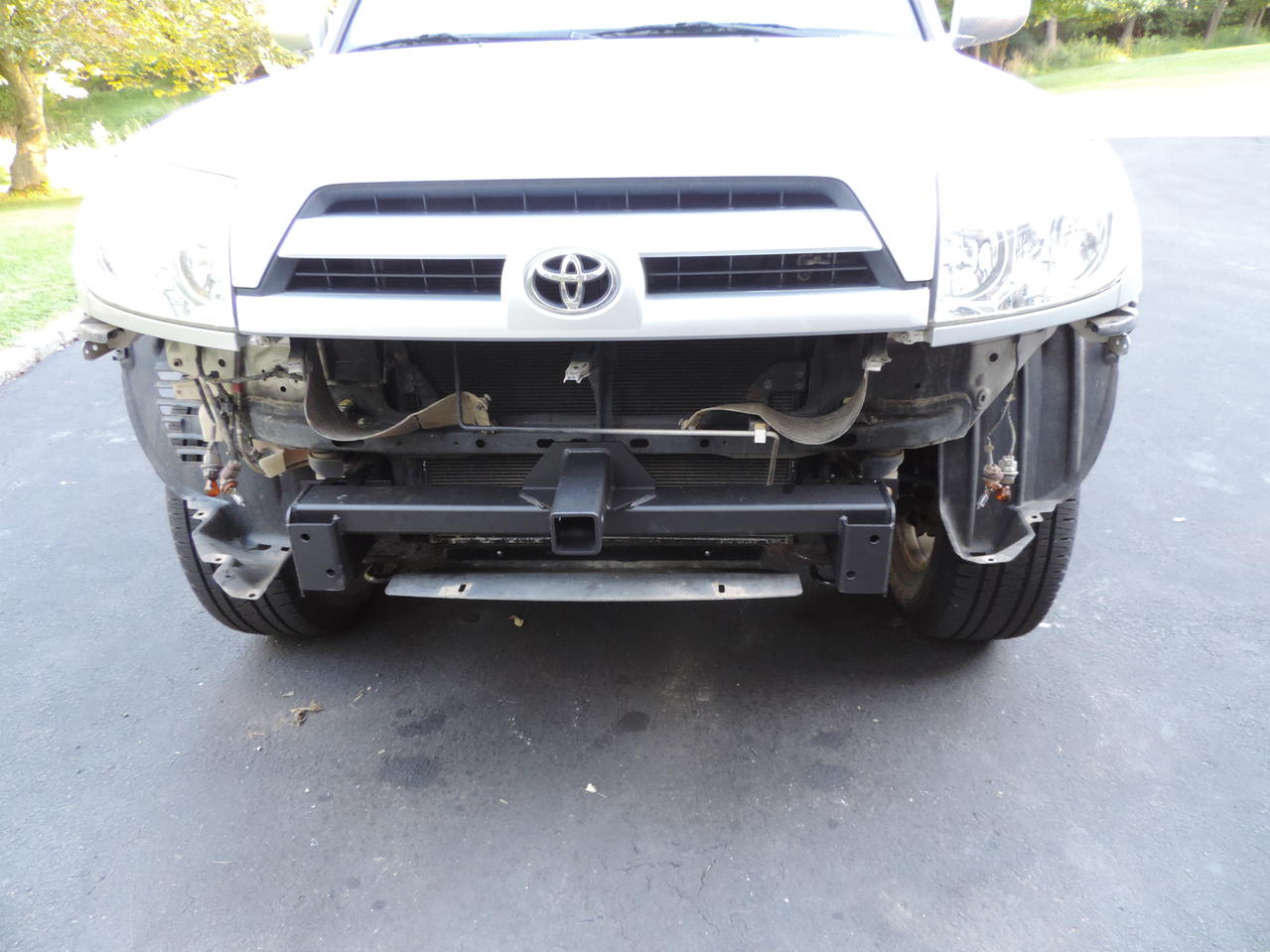

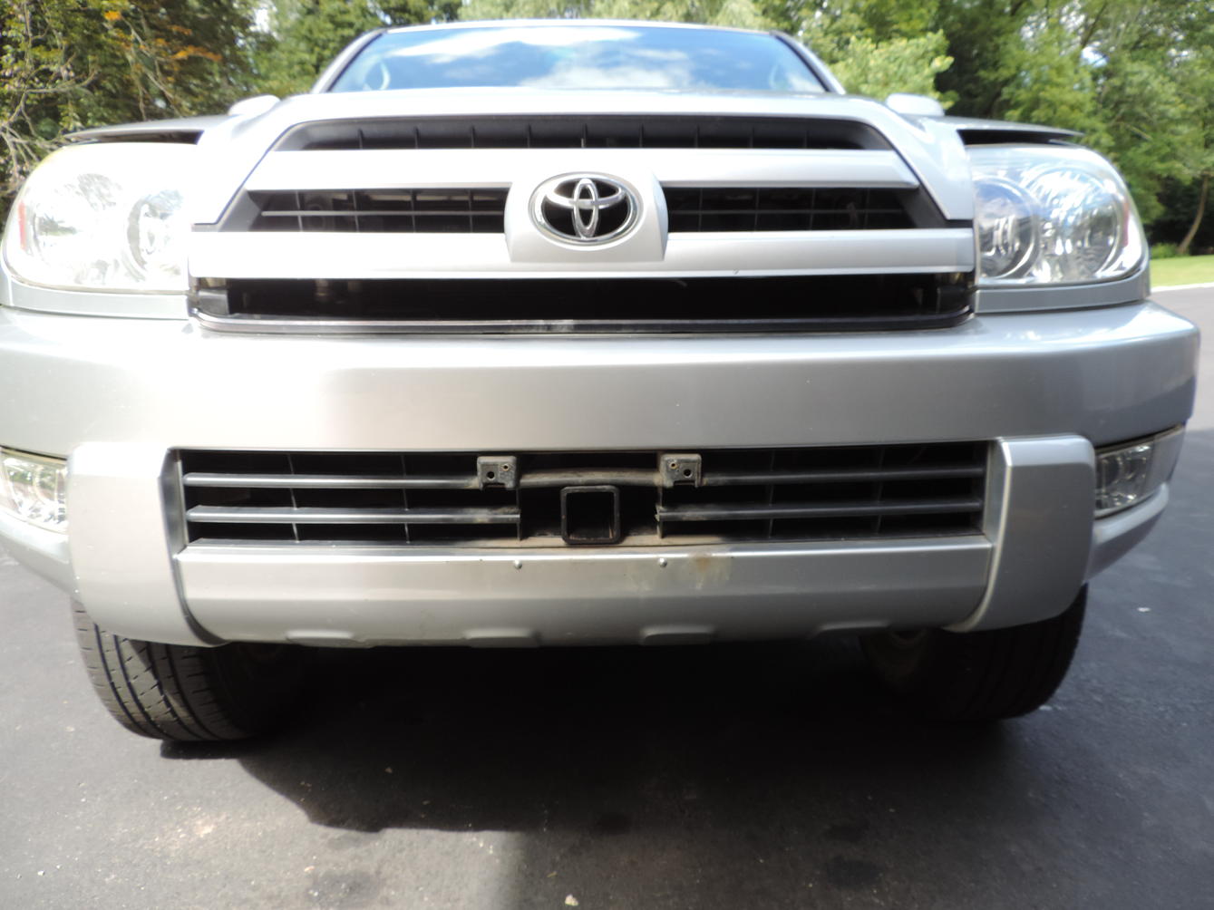

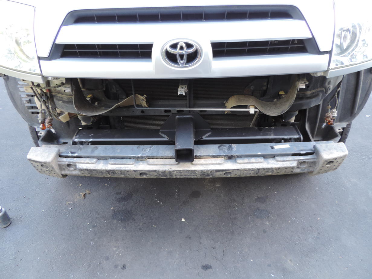

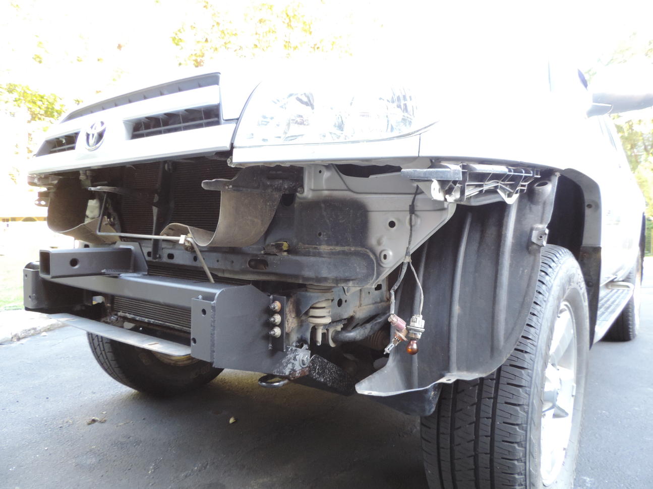

I was in the same boat with my 2003 SR5. I gave the Curt one on Amazon a shot,free shipping/free returns. All I had to do was bend the 2 front tow rings down. and source 2 longer bolts. I believe I paid $143 shipped. I couldnt justify dropping $350+s/h for the CBI one. Its nice but way too$$$.

picture of before and after the bumper put back on.

So just to be clear... all I'll need to do is bend down the tow loops on the rig, get longer mounting bolts and it'll be a direct bolt on?
Bend what? I bend nothing it was a direct bolt on to the tow hooks
