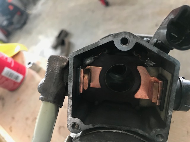

So I yanked my starter
Kyngfish
And it was all gunked up with oil inside. Pretty sure my valve covers are leaking. Safe to spray brake clean in there? Normal?

The brake cleaner will also eat the paint on the electric motor body. Make sure whatever you use is also paint safe.
-Charlie

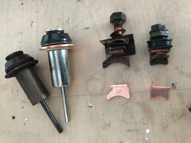

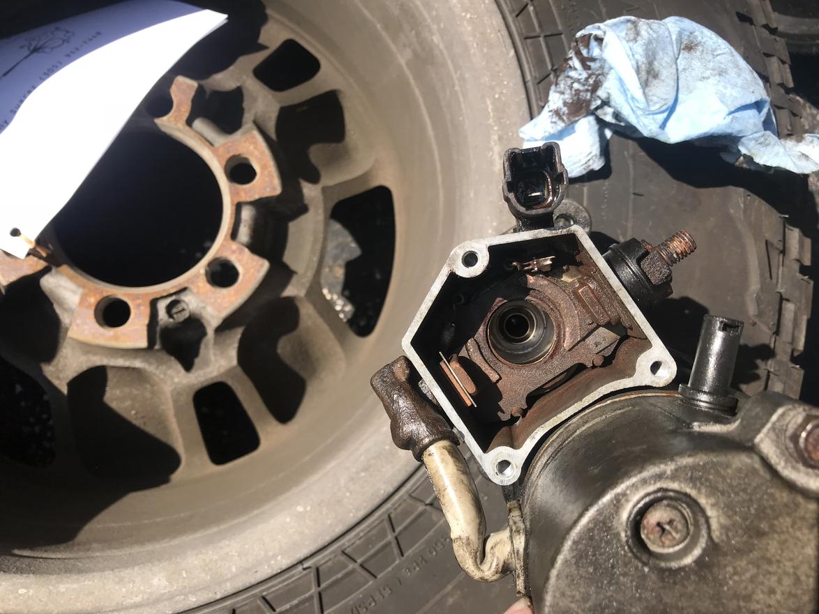

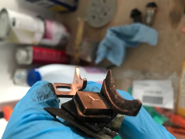

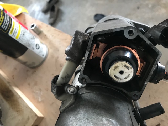

Well I used one of those Ebay kits and cleaned it out. Car is starting right up, so I guess problem solved. I'm sure if I ever have to do it again it'll be easier, but that was one of the least fun jobs I've ever done, everything was a pain in the ass and I also have a bad flu. And it's not like I don't have all the right tools, because I'm a tool addict. This morning I felt like if I ever had to do that particular job again I'd go ahead and sell the truck.
