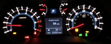

A assassin New member Dec 16, 2018 #1 Just installed my lift and now I have a lot of dash lights. I’m thinking it’s a wheel speed sensor (abs) wire harness but how do I tell which one? Took it to oreillys to scan and no error codes? Attachments F305F811-9315-4F21-AB15-AA4CF28403AD.jpg 78.7 KB · Views: 531
J jamesq New member Dec 16, 2018 #2 I had similar issue when I have my 5100 installed. Mine was due to ABS wire stretched on one side. Sent from my iPhone using Tapatalk
The_Green_Wang New member Dec 16, 2018 #3 Looks like it! I did a write up for just making a wire and soldering the end points to the wire. https://r.tapatalk.com/shareLink?ur...share_tid=264983&share_fid=10034&share_type=t Sent from my SM-N950U using Tapatalk
