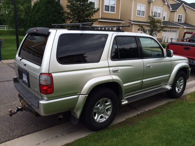

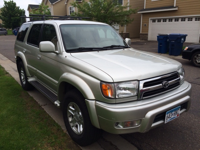

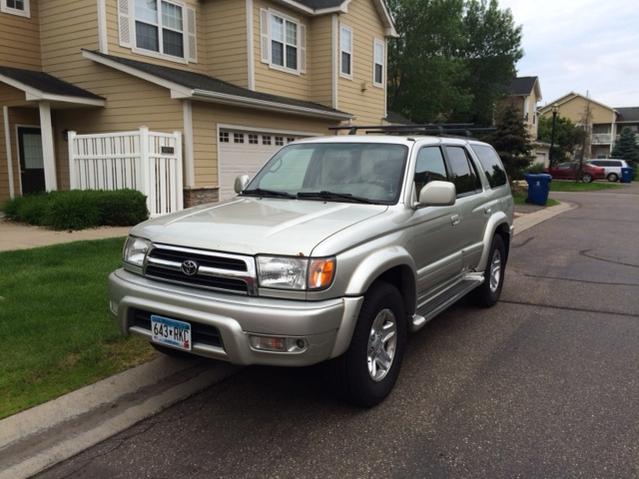

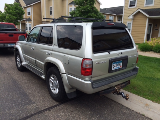

I was finally able to get my hands on a 3rd gen T4R. I've been searching for a long time and with a limited budget made it hard to find something that would be worthwhile. But then, on CL in my local area, I found it.
Here's what I've found:
2000 Limited 3.4L 4x4 w/ E-Locker!
It's got 205K miles on it and 2 owners (making me the 3rd) Best part is, the 1st owner had all the maintenance records and receipts up to 180K. The 2nd owner didn't do as good, but I'm hoping to get it back to new. Body has one small rust spot on the hood, and the frame has some surface rust, but that's all. It came with the Yakima rack which is what I would have put on anyways, and has K&N air intake.
My initial list of things to do will be tuning it up. I know it needs some help in the suspension. The previous owner did quite a bit on front suspension, so I'll be checking over all that as I go. Also need to do a cleaning job on the interior. He left a lot of junk in there.

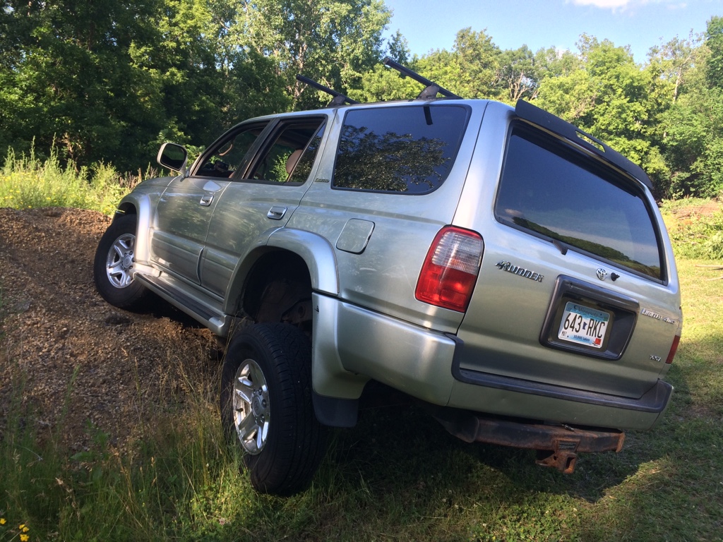

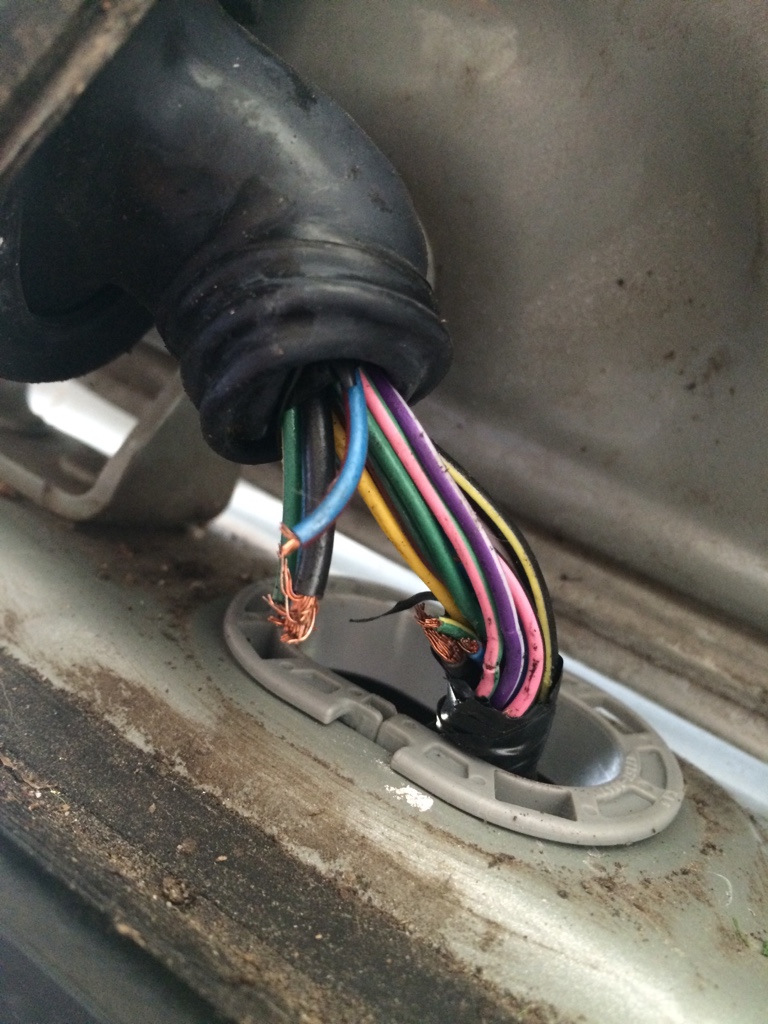

So... Did a little digging today. Noticed the MPX B fuse was blown in the engine fuse box. changed it out and as soon as I plugged a new one in 'pop' it blows. Any ideas for isolating a short in the rear hatch?
Possible culprits:
latch mechanism
wires from body to hatch
Other wires inside rear hatch.
I know this is the problem area for why my locks aren't working when the key is out of the ignition, and I'm willing to bet this will solve my rear window problem (can't raise/lower window with key) as well as the dome light in the rear does not work when in the 'door' switch.
I'll keep you posted to progress though. Still learning so much about this truck! I'm loving it!
Figured it out! 4 wires severed and one sheath broken on the wire bundle from the cab to the hatch. Dome light is working, rear window will open/close with key, power locks work, and the key fob works. Now the MPX B fuse holds. Feeling better about it already!
