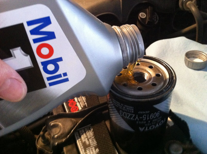

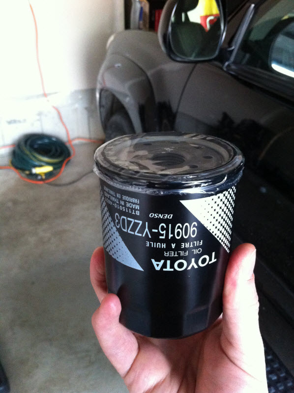

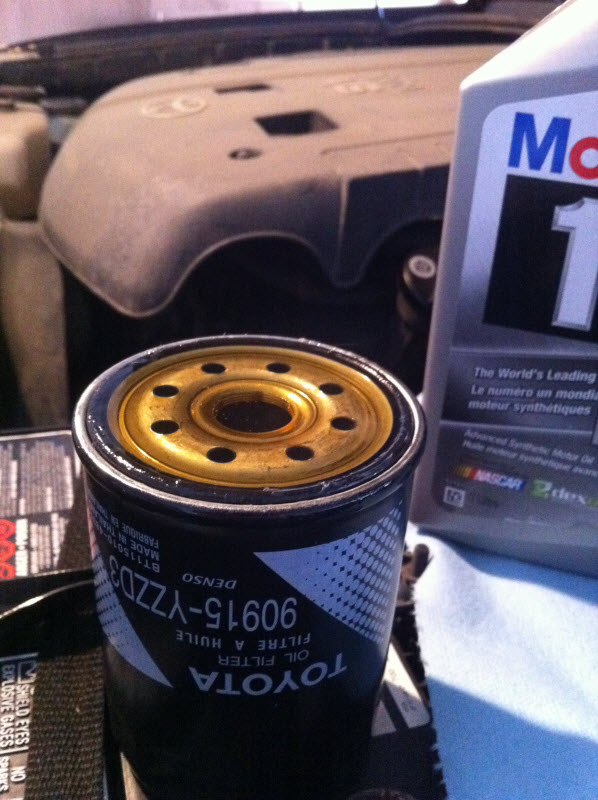

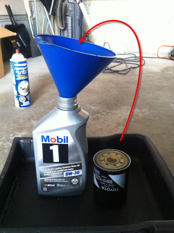

Hi everyone,
I have never had a car with an oil filter facing down. As soon as I started the oil change, I had to think of a way how to soak the filter and avoid any oil dripping upon the installation of the filter.
This is the first thing that came to my mind:
1) Take the filter =)
2) Pour the oil into the filter until it is fully covered in it.
3) Let the filter soak. In the meantime you can clean the filter housing =)
4) Once the filter is soaked, pour the excess oil back into the canister or into the engine. Give it some time and make sure the oil doesn't drip from the filter.
5) Attach the filter to the engine.
I know, this "trick" is too obvious and maybe not worth creating a new thread. But, as I mentioned earlier, I have never had a car with an oil filter facing down, so I just thought I'd share my own "oil filter eureka". =))
Thanks!
Max

I have found that if you just simply fill it to the top quickly then leave it set as you do the drain and fill, it will soak up what you have put in and will not drip.
