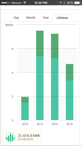

I have solar panels for just over 3 years now. I lease them. 20 yr then $1.00 to buy them. All repairs to any equipment is done at no charge. if the roof had to be done they would remove and reinstall 1 time free of charge. Its a 7.8KW system 27 panels. At this point at my electric rate I have saved over $7,000.00 I layed out $2k out of pocket so I am way ahead already. My advice is make sure you get to keep your current electric co. and a "net energy meter" is installed. This will go backwards when your panels produce more than you use. I wouldn't go with a company that wants you to switch to their company and just offer you a reduced rate. Best thing I ever did. They have never had an issue.

My company is Solar City. They take care of any repairs and I have an app for production on daily, weekly, monthly and total. At the end of 20 years I own everything, panels, and all equipment for $1. This was 3 years ago and I think some of the incentives might be different and vary by the state you live in but I would do it again. There are many more options now than when I installed so check them out and see whats best for you. BTW my electric bill for May-June was $77.00 2800sq ft 2 level house w/ central air on the last 2 weeks of June. If you have any questions I am happy to answer them.
