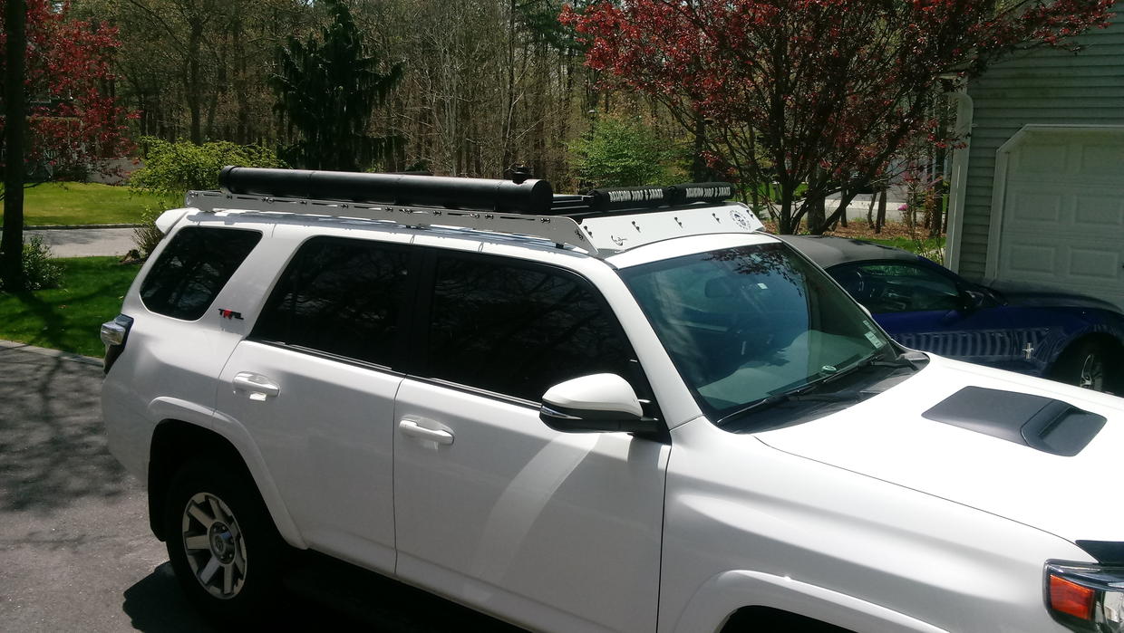

Solar surf Shower and surfboard racks done.
now to get in the water!

Looks like he painted it. If so it should hold up ok. I like this idea and since it sits on top you should get some nice hot water too!

I look forward to reading about how well this heats the water. The PVC pipe wall is a good insulator, and should normally prevent heat transfer from the surface to the water. (That's why copper pipes sweat in humid conditions and PVS don't. And why aluminum or glass cups sweat and plastic cups don't.)
I hope it works for you, as that would make an inexpensive alternative to the plastic WaterPort or aluminum Road Shower.

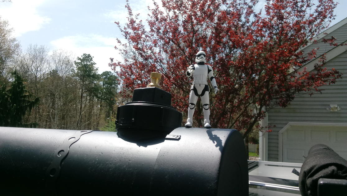

Would it be possible to use a bike pump to pressurize the water or is it 12v air compressor only?

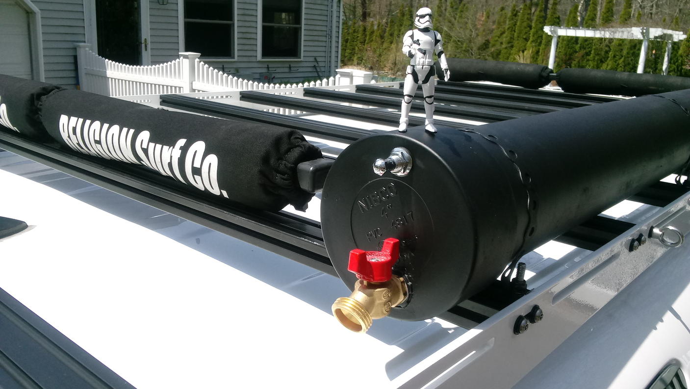

Can you provide a list of parts and where you purchased them?

i will post a list and links to all when i get a moment this weekend.
Edit - had some time before heading to work-
10' of 4" pvc - $23.10
http://www.homedepot.com/p/4-in-x-10-ft-PVC-Sch-40-DWV-Plain-End-Pipe-531103/100156409
2 - 4" end caps - $4.02
http://www.homedepot.com/p/4-in-PVC-Sewer-and-Drain-Cap-4P06/100172701
1 schrader valve $8.25
https://www.amazon.com/gp/product/B01BRVCQ7K/ref=oh_aui_detailpage_o05_s00?ie=UTF8&psc=1
1 pressure relief valve - $3.39
http://www.homedepot.com/p/Husky-1-4-in-NPT-Draincock-HDA71000AV/100095680
1 - 2" clean out with cap - $2.29
http://www.homedepot.com/p/NIBCO-2-in-PVC-DWV-Spigot-x-Cleanout-Adaptor-with-Plug-C4816HD2/205808371
1- 2 1/4 hole saw - $11.01 (you will have to file the hole a little larger to get a good airtight fit- use lots of PVC cement)
https://www.amazon.com/Milwaukee-49...1493726179&sr=8-1&keywords=2.25+inch+hole+saw
1 roll of strapping - $6.81
http://www.homedepot.com/p/Basset-Products-3-4-in-x-50-ft-Perforated-Duct-Strap-DS50-1-22B/205871087
1 can flat black paint - $3.87
http://www.homedepot.com/p/Rust-Ole...127/202246266?keyword=krylon+flat+black+paint
1- PVC cement and primer -$7.20
http://www.homedepot.com/p/Oatey-4-oz-PVC-CPVC-Cement-and-Primer-Handy-Pack-30234/203561639
$70.12 + tax and shipping
