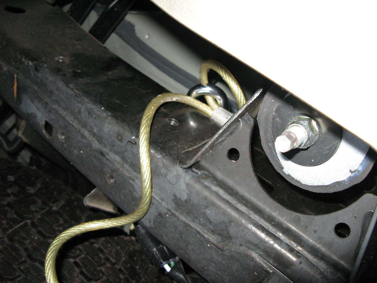

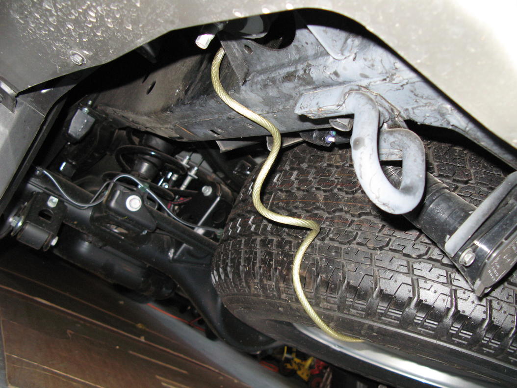

There was a lot of threads on people getting the cable cut and losing their spares. I bought a coiled heavy duty aircraft type security cable,and pulled it through my frame and the spare and locked it up high where it's not easy to cut off the lock.
The tire thieves have so far left my spare alone.

My spare tire to frame cable and locking system.
Hers is my spare tire to frame cable locking system.

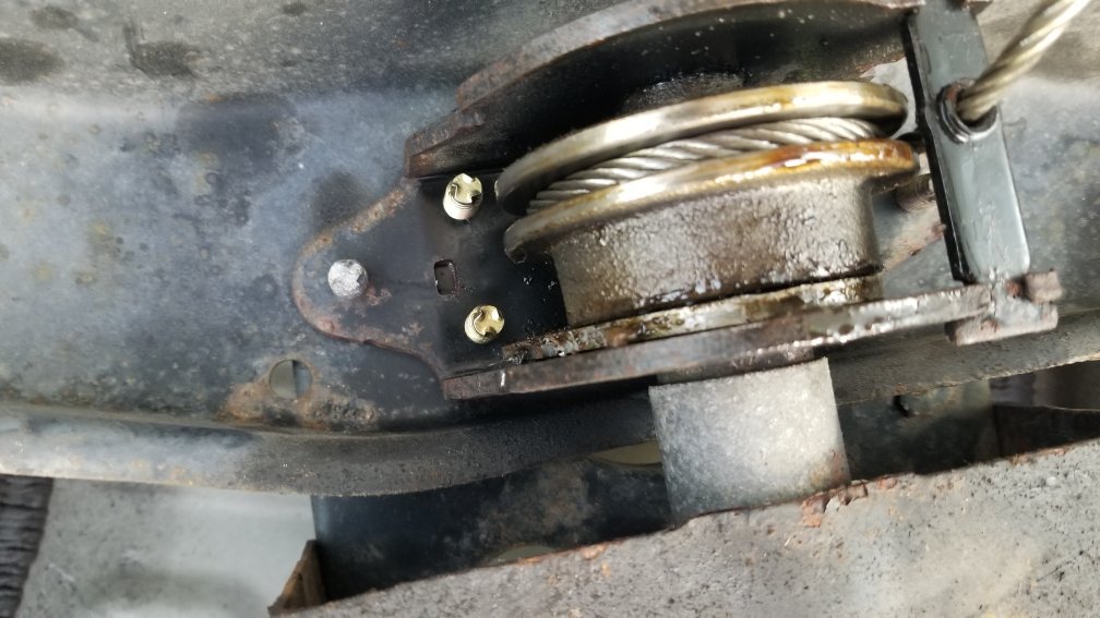

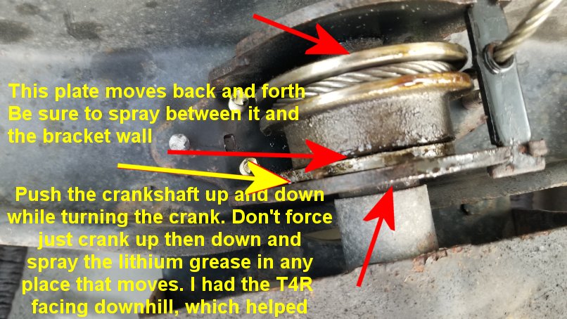

The one on my 2004 got stuck going up but down was okay. I hadn't read in here about the problems. If your carrier is rusted then it's a pretty difficult job to get to the bolts. Land Cruisers and Sequoias have a lot more room to access the top bolts. If they're rusted you would probably need an air chisel to cut them off. Even then, the bolts are threaded into the cross member and have to be drilled out.
I took the plastic cover off and shot WD-40 then Lithium grease into the mechanism while turning and jiggling the crank. Eventually it freed itself and I was able to put more grease on it. It's going to be a once a year maintenance item for me now.
In the attached picture you can see 2 of the bolts coming down from the top. There is almost no clearance on top of the cross member for a wrench.

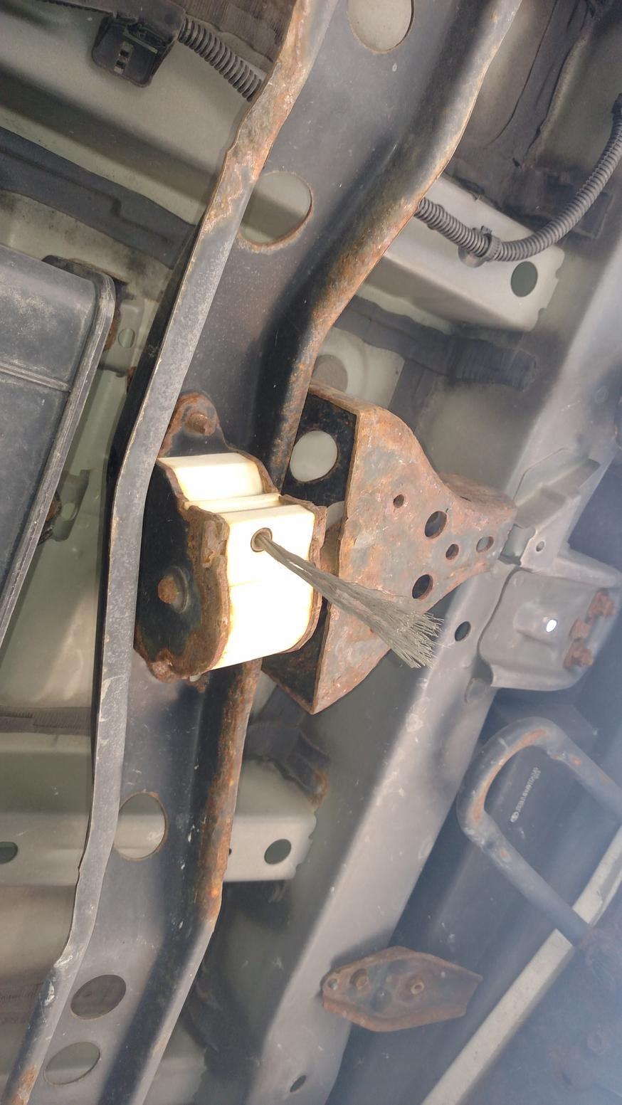

It's a gigantic pain in the rear but it's not particularly difficult, just unpleasant. Our 2009's hoist cable had totally frozen into place -- I assume due to corrosion. I ordered the "new" replacement part which, like 5th gen 4Runners, has a chain rather than a cable, and the six bolts that attach it to the car.
I cut the old cable so as to drop the spare. Everything in terms of mounting bolds was rusted together so while I had the part on order, I stopped by the local mechanic and had them cut the old one off. They didn't even charge me for that.
We don't have much rust under the car, but for some reason the area immediately above the spare was pretty rusty. I cleaned up the rear with a wire wheel and painted on some POR15.
Recommendation: you definitely want to order the OEM bolts; you might as well do it at the same time as the new hoist. They're just metric bolts, I forget what thread, but at any rate they are perfectly sized to fit into an insanely tight space. To get them started, you kind of have to use your fingers and scrape your knuckles; once they're started, you can get an open-ended wrench, then a short socket on there an get them tightened down. The hardest part of the job is getting the bolts started.
Long and short, I can't see how a dealer -- which, after all, has all the right tools -- could take more than an hour to do this job.
