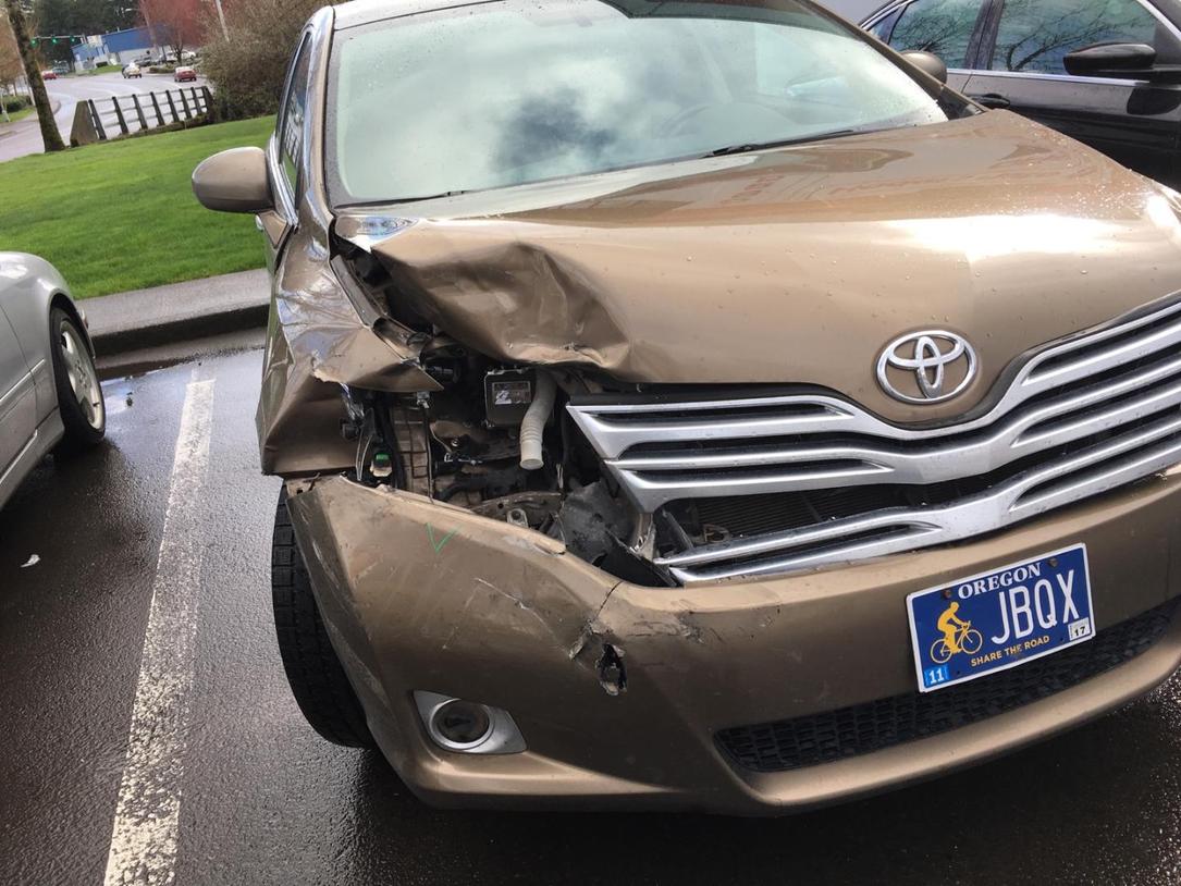

Dual cases now are waiting for another daily driver to enter the picture - this happened to my wife's Venza on the way to Cannon Beach for her birthday...
All good. Only going about 10mph at impact and it still got totaled. Hit just right so it bent the front rail.
Now I have to find another Venza.
