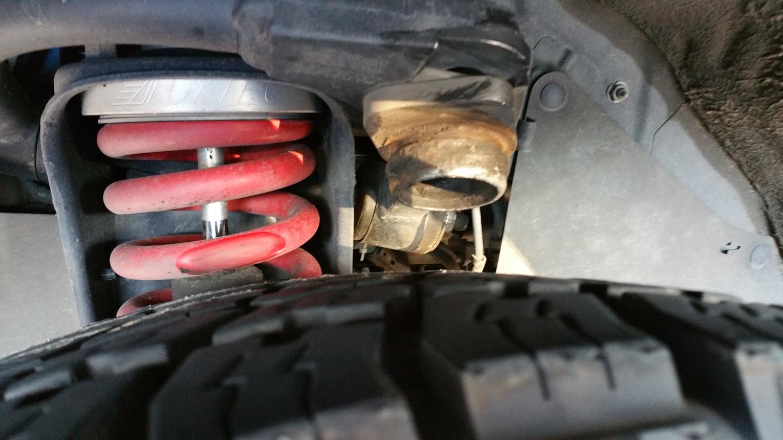

I frequent the board a lot but never did any posting. Today on my way to work my driver side UCA spine came detached from the control arm. Waiting for a tow now. Thought I would share. Does this happen quite often?

There have been several members who had welds fail on the actual arms. I've seen posts where the ball joints wore out quickly, but not actually failed. Sorry man, that sucks. Glad you and truck are ok.
Looks like a ball joint failure, not a failure of the actual arm.

Thanks. Hope the damage isn't extensive. I'll find out soon enough.

That ball joint looks pretty dry! Better off doing all of them, not just one side.
I ended up getting both done for now. I'll switch them out once I weight out the pros and cons for available alternatives. It happened after I got off the highway and crossed some train tracks. Nose dived without any indication of something being wrong.
