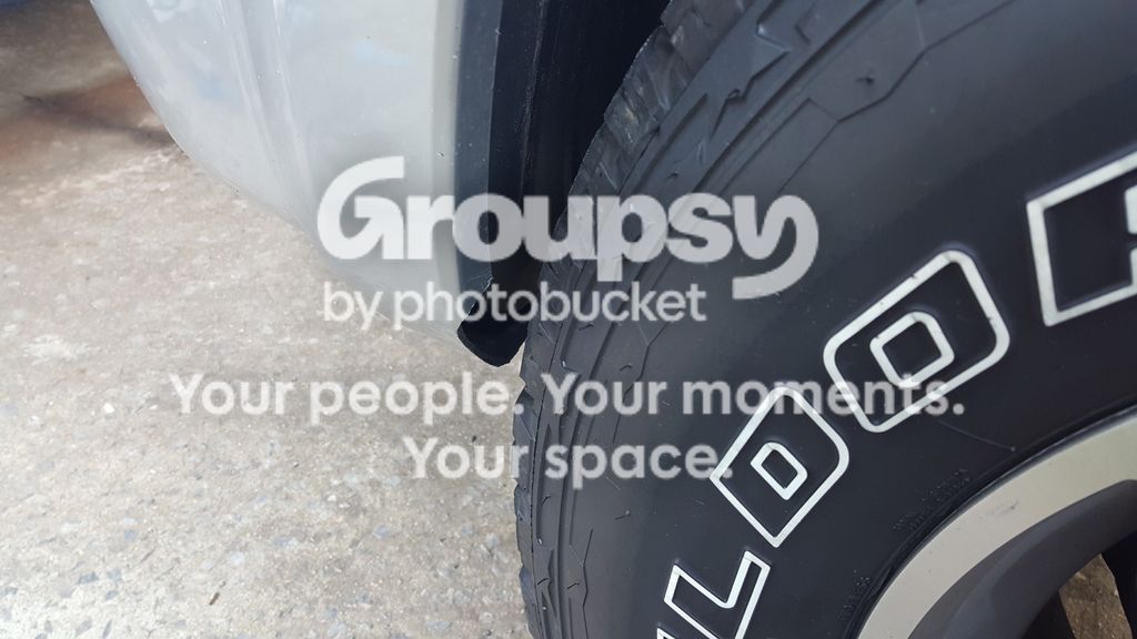

Yeah even without chains you will rub; I have that exact setup---spidertrax, 265/70/17, 2012 SR5 wheels. Just tackled this ptoblem.
Before
After
*sigh*
Thank you guys for the help - I was afraid that was going to be the answer. I suppose I'll just chain up the rear and hope for the best.
