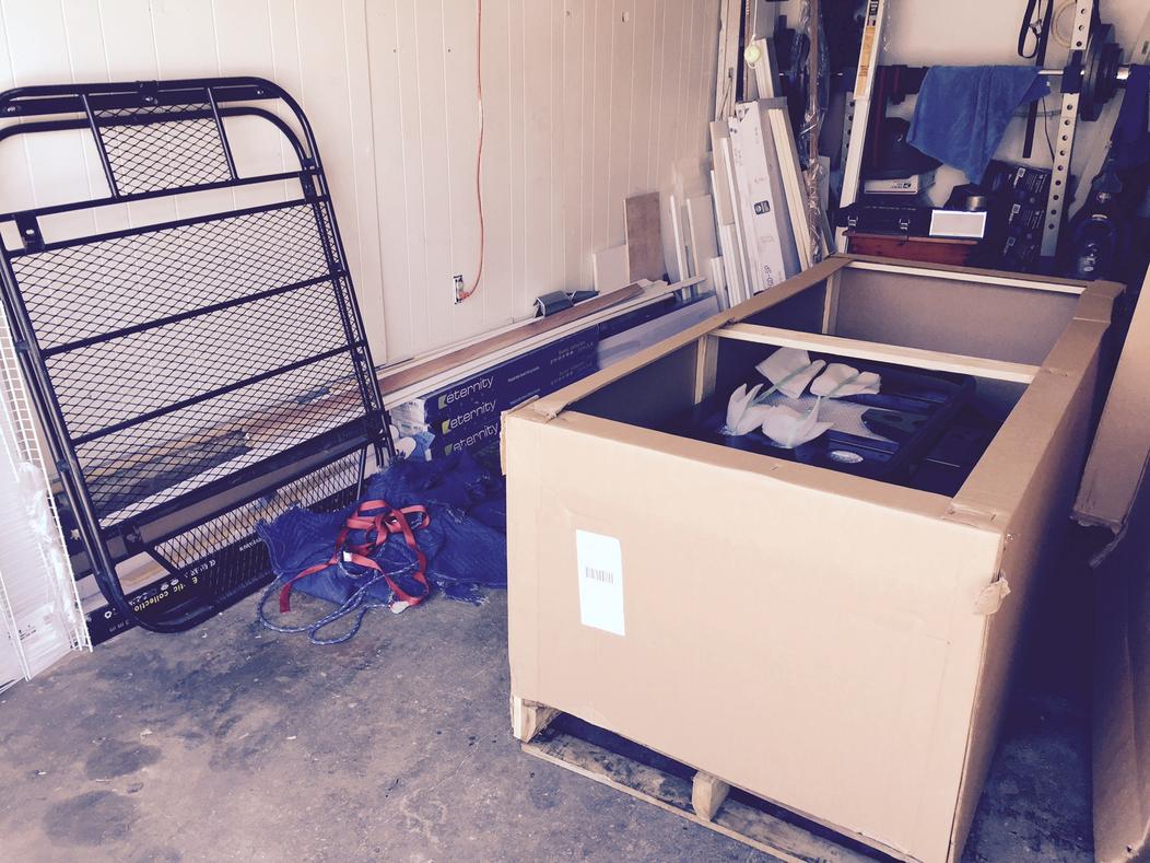

The wife texted me this photo :banana: I feel like a kid on Christmas morning. Freight box appears to protect the bumper fairly well. Can't wait to get this bad boy on.

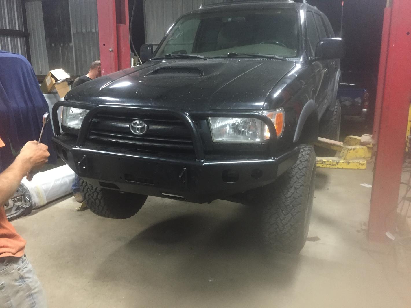

Went to Shrockworks today, thanks to Mark for waiting. Stupid Houston traffic. Saw the shop and orders going out. Nice place, and nice guys, off to put it on the 4Runner. So stoked!!!!!
