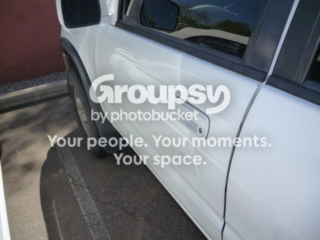

Going to get sliders for my 4Runner. Have decided to go with Shubbs HD-SKO's. This is a big step for my 4Runner. I have the SR5 Flares w/ front mud flap. How well will the sliders work with the flares? I'm considering cutting the rear front part of the flares that hang down (in front of the rear tires) to allow room for longer sliders. Is that worth the effort?
Here is the best picture of my flares on my rig but I also included a link below of other rigs with the same flares.

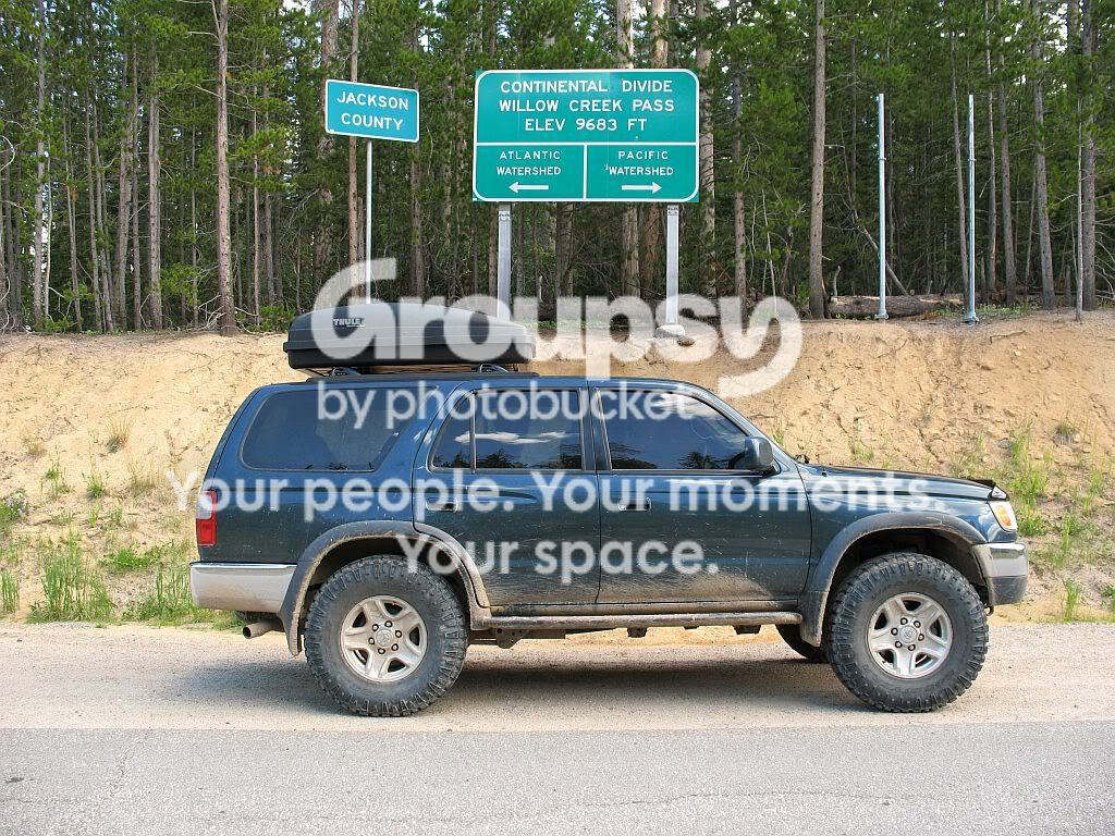

Stubbs HD-SKO SR5 Mud flaps, no body lift version
When I called in to order, Richard asked me all the important questions about my rig. He had all the ends handled and made sure I got exactly what I needed. Great service, great product. They are made shorter for rigs with the mud flaps, just be sure to specify. My sliders are gently touching the mud flaps/flares front and rear, installed with a 7/16th gap between slider and pinch weld.
Painted with Rustoleum Hammered Metal Black
Grip tape (great stuff...rubberized, won't scrape your legs up when wearing shorts) 3M 7736NA Safety-Walk Medium Duty Tread - Black 1-Inch-by-60-Foot Bulk Roll from Amazon
DSC08199.jpg~original
DSC08200.jpg~original
DSC08198.jpg~original
DSC08197.jpg~original
Thanks for the pics!
I'm planning on keeping the front mud flap. What I was thinking about was cutting the flare in the forth picture to extend the slider a little more if he will make it that way. Assuming an inch more of slider will protect better?
